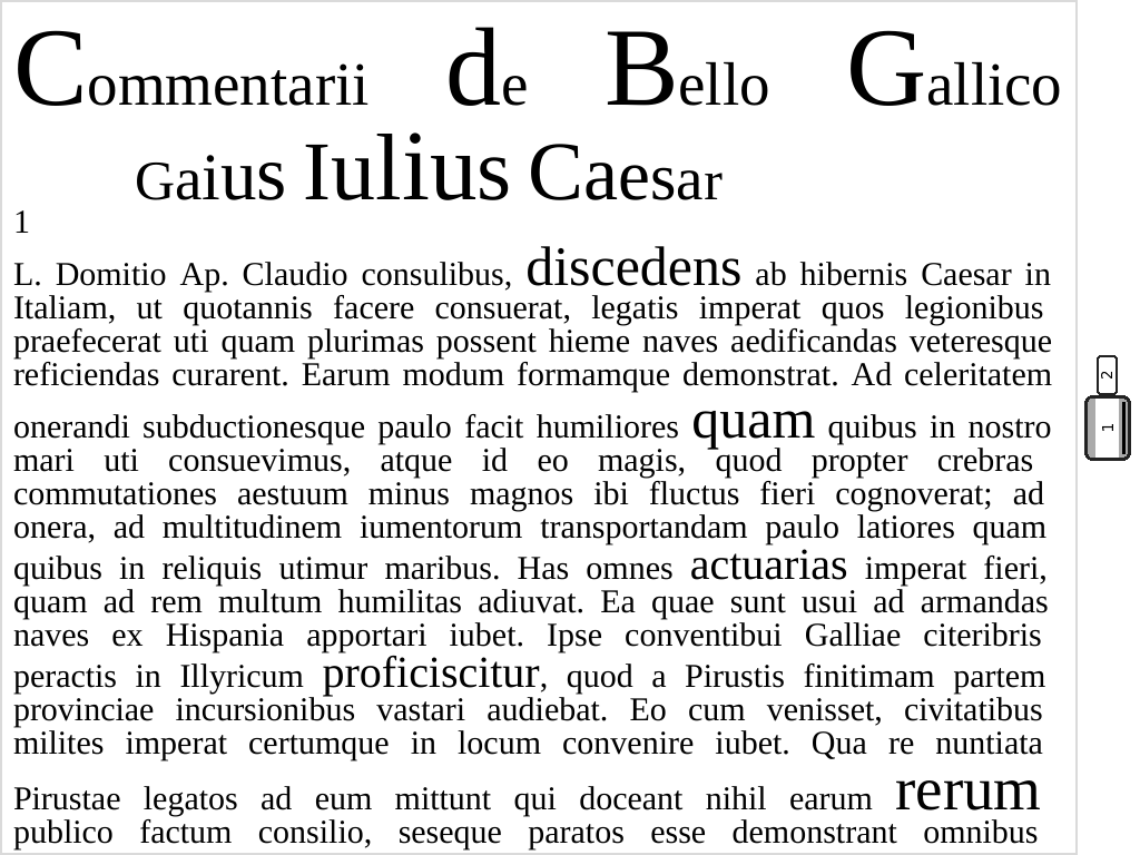

pViewer : pdf and lit viewer w/ reflow; check the screenshots.
Install: unzip in a folder on your sd/mmc card; to start select the folder in contentLister view. Should work fine with sw. 2.12.
Controls : first thing you'll see when starting the sw.
pViewer 06:
I know I said 05 was the last version but .... it's not.
So what's changed:
-- better pdf text and font handling
-- landscape mode
C.
ID:	44419   Click image for larger version
ID:	44420   Click image for larger version
