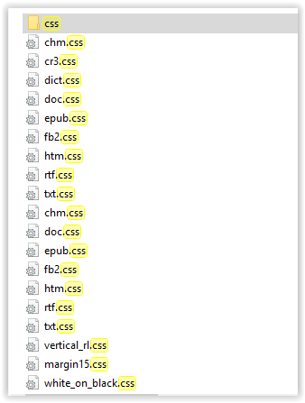

Thanks for the reply. I can't find "kobo_extra.css" on my e-reader, even when I check my Win to show hidden and system files/folders. There are a bunch of css files, but none with that name (see: attachment).
Name:	Screen Shot 02-29-16.PNG
And I wouldn't expect you to find it. It is a file you can create on the device. With the appropriate option set in the driver, the contents will be appended to all stylesheets in kepubs and epubs when they are sent to the device. Details of this are in https://www.mobileread.com/forums/sho...56#post2584056
Why do you have so many CSS files on the device? I can't think of reason for them to be there.
I did everything as in these instructions and it doesn't work. Those css files I have come from mods I have installed, mostly from KOReader.
