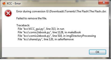

i always get the error failed to remove the file...

Finally, someone. I need to know everything about your PC. What Windows version you use? What AV? Any third party applications that might interfere with file access?
I have win 7, malwarebytes premium, i think no other process can block kcc.
If u want more information, tell me.
heres the error
i get this error in some hqs. 40% in 100%
Name:	Sem título.jpg

Could you check if disabling malwarebytes fix the problem?
Yep, didnt work =(

I'm out of ideas. I never replicated this issue in any environment. But you are not first person with this problem.
Something blocking access to KCC temporary files.
Does maybe a torrent client hold/lock file you're trying to convert? (assumption based on screenshot of the error and path G:\Downloads\Torrents\The Flash\The Flash.cbr)

KCC temporary files are blocked - not source files.

It shouldn't be too hard to find the locking handles. For example with Handle utility from Windows Sysinternals. Something like
handle.exe > log.txt
in command prompt.
