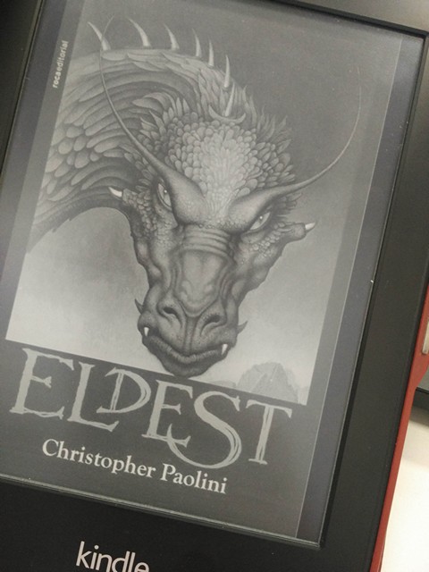

eschwartz
Ex-Helpdesk Junkie
eschwartz's Avatar
Posts: 19,421
Karma: 85400180
Join Date: Nov 2012
Originally Posted by MrCaringi View Post
Thanks Bro,
So, new info for me here:
I dont need to install the JB, I can "jump" to 5.7.2.1 ans reinstall SS hack (and python), Am I right?
Yes, you are already jailbroken right now and that is all that matters.
Old 02-17-2016, 03:58 PM   #763
MrCaringi
Venezuelan
MrCaringi began at the beginning.
MrCaringi's Avatar
Posts: 52
Join Date: Jan 2014
Location: now Living in Mexico City
Device: PW2 (B0D4 Series)
Thumbs up
Thanks guys, I'll upgrade to 5.7.2.1 then...
Ill post results soon.
Here I am:
I dowloaded the FW file from Amazon, installed
during instalation I could see a "** bridge ... " message, it was so fast and I wasnt paying attention
I update some Kual extension,
And put librariansync, python, and linkss .bin files into MRPI root folder,
I reset it, openned the KUAL, go to install MRPI Packages options,
I cpuld see how MRPI installs the 3 packages in the proper order (python, librarian and finally linkss) and done... it was so easy... I love it
Hope to pay back for your effort!
UPDATE 2
I put back the "update.bin.tmp.partial" folder in the root... "just in case"!
UPDATE 3
I just figured out I didnt install the last version of python nor linkss, I get it from "Snapshots of NiLuJe's hacks"
Updated via MRPI and everything goes perfect!
ID:	146440   Click image for larger version
