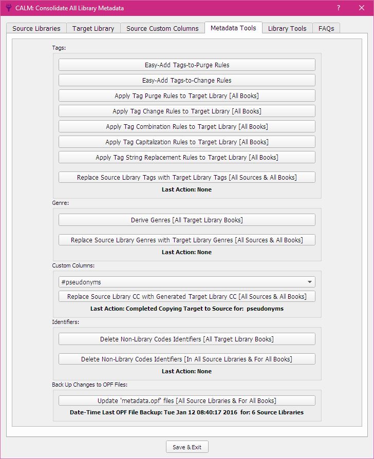

Version 2.0.13 - New Metadata Tool: Copy Target Library CC to Source Library CC
Version 2.0.13 -2016-02-03 New Metadata Tool: Copy almost any Target Library Custom Column back to the mapped Source Library Custom Column, replacing the Source with the Target. Analagous to what is already available for Tags and Genre.
See the ToolTips on the Metadata Tools Tab for details.
An image is attached below. The new Tool section is named 'Custom Columns'.
DaltonST
