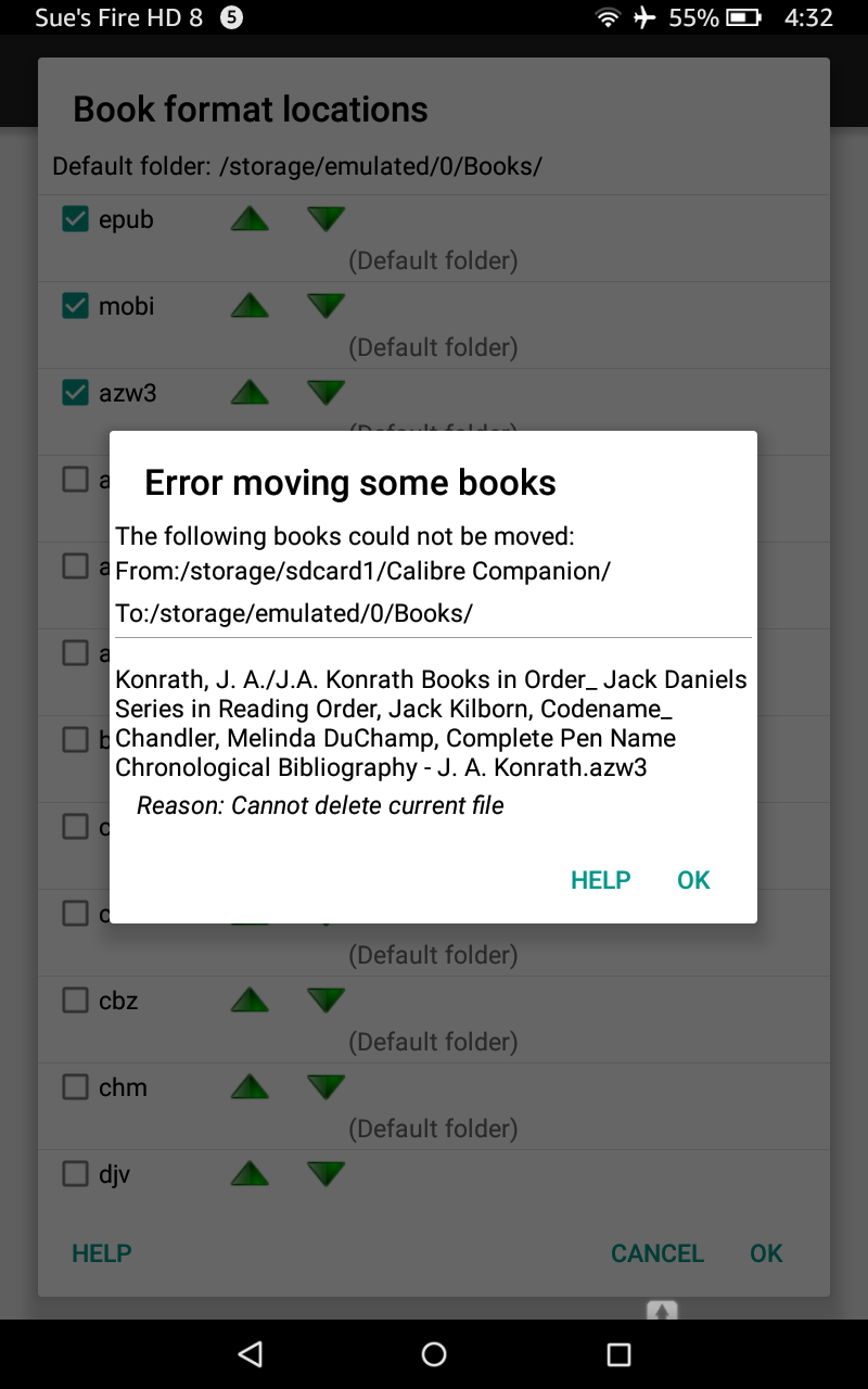

Books with missing files show a mobi book is missing. The screen shot shows where the missing book is - in Konrath, J. A. (1). The other Konrath, J. A is missing the period at the end and contains a book that is not missing. Amazon seems to have a problem with a folder when the last character is a period, but only on the external SD. I will create another post for that - I thought it was only ES File Explorer
I can't successfully move all the books back to internal. See screenshots. All books with problems have an author with a middle initial, which should create a folder ending with a period.
Maybe my SD card is faulty? I will look for another.

I'm preparing to test the latest, so I'm looking at these problem books. All the ones that had an error because it couldn't delete the current file actually did copy to the new location, it just didn't delete the old. I don't know if this is expected behavior, but it makes things easier for me. I can just delete all books from external SD and re-download the one not found.

I re-downloaded my one book, but the path looks wrong. In addition to substituting a period to underscore it also changed the comma to underscore. See the two Konrath folders in the screenprint.

I just tried moving my one azw3 file to the external SD, and the path created still had the missing period at the end. I am using alpha 3.
Re not deleting the files: no, that isn't intended behavior and it isn't behavior that I see. I suspect that it happened for you because of the various path name changes in the alpha releases. A book file could have been orphaned.

I decided to spend the time to determine what calibre does to paths and, if possible, do the same thing in CC.
Calibre first "ascii-ized" the text, getting rid of non-Latin characters. CC won't do this.
  1. Calibre next changes the following characters to underscores -- characters that are not:
    • letters, numbers, or a space
    • !, $, %, ^, &, (, ), =, -, {, }, \, [, ], @, ~, ', #, comma, period, _, and /.
  2. Calibre next changes any leading period to an underscore and removes all trailing periods.
  3. Finally, calibre removes any empty path segments, e.g., aaa//bbb becomes aaa/bbb.
CC now does these things as well.
CC will optionally remove accents from characters.
These changes deal with the comma -> underscore problem. It won't happen any more.
Attachment 146342
This implies that you didn't resend the book or that the "replace" option is not checked, because CC alpha 3 would not leave that dot in the folder name.
