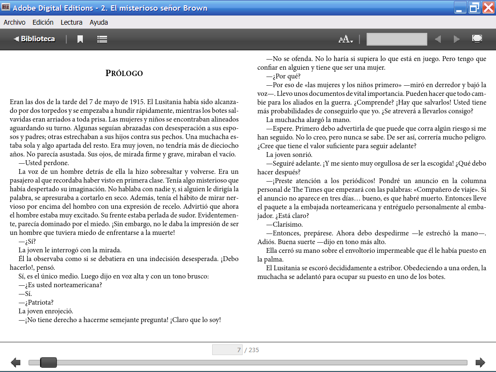

Again: no. My ADE is showing soft hyphens all the time, regardless if they are at the end of a line or in the middle of a line. If its there, its been showed. Thats the reason why i still stick to this version of ADE, as it shows almost everything like my PRS650.
Well, watch the following screenshots of my ADE 2.0:
ID:	146204 Click image for larger version
The ebook showed is full of soft hyphens and they look fine in ADE.
Regards
Rubén

Did you define the language of your epub with lang="es" (or xml:lang="es") in the <html> tags?
Glup!... I did not do it systematically, big mistake.
With the homework done, ADE works perfectly.
¡Muchas gracias Rubén!

¡De nada jbacelar! Me alegra saber que dicha sugerencia solucionó tu problema.
