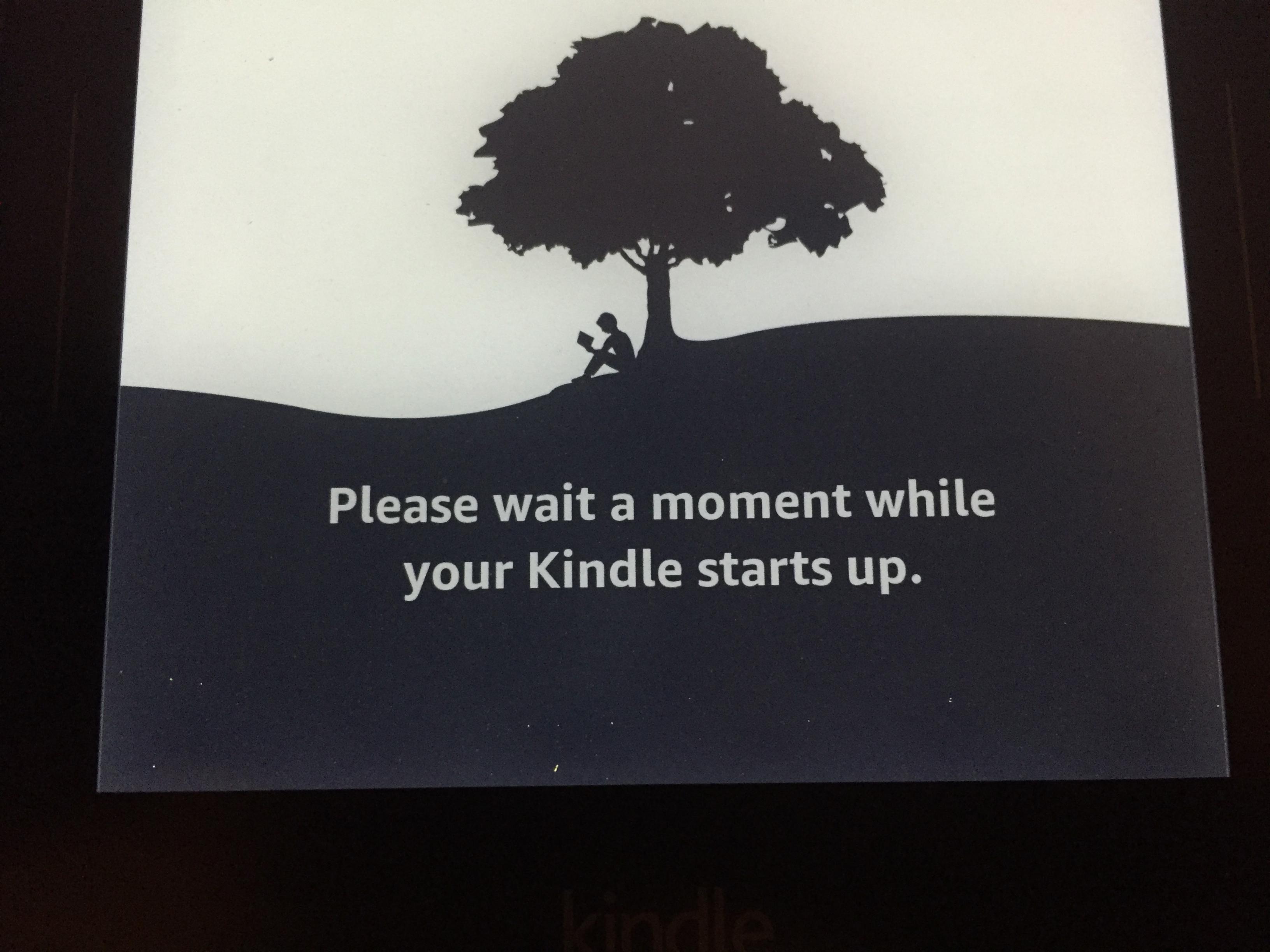

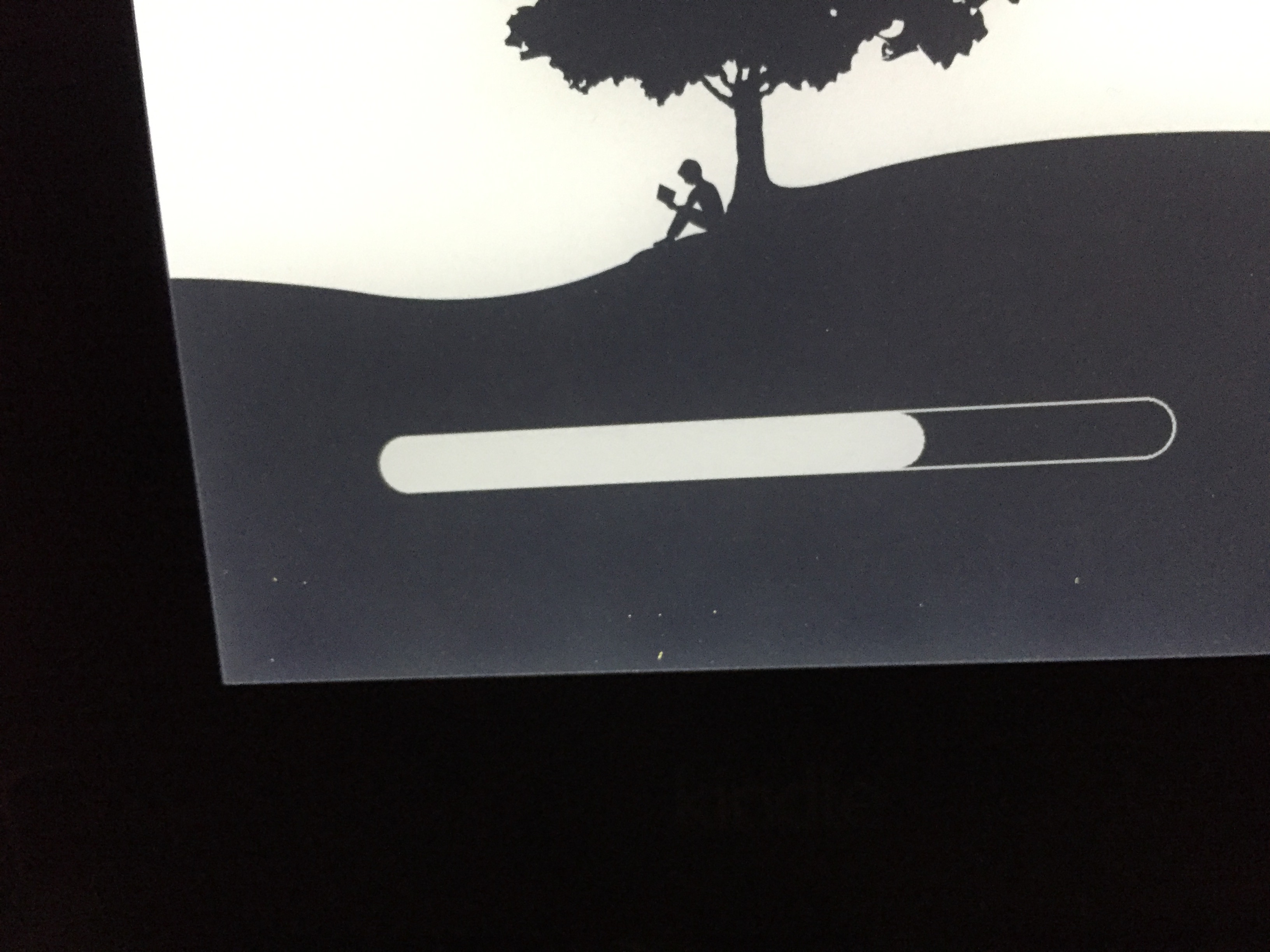

So my Voyage has quite a few dust specks under the screen, mostly outside the reading area. Most of them aren't visible the majority of the time but there's one particularly thick/large one that I do often see when reading (photo attached). I also have a small dead pixel in the middle of my screen. I'm honestly not sure how much this is bothering me. I keep asking for replacements and the replacement Voyages keep having severe screen gradients. My issue is that my current Voyage's screen is a sharp white (comparatively speaking) and I'd hate to trade it for a beige/yellow screen.
I attached a photo, they're all very visible because of the black picture in the loading screen. However, when turning pages or opening books the dust specks are still quite visible.
What does everyone think? If your kindle had this, would you keep trying for replacements? My kindle is my most prized toy, so it kind of bothers me that it has imperfections.

I can't figure out what is bothering you from those photos and your post. Is it bright spots or dark spots? Have you cleaned your screen?
There is no such thing as a "dead pixel" on e-ink. You may have a burst e-ink capsule, which will appear dark. You may have defects or damage to the light layer, which will appear bright when the light is on, and disappear when the light is off. You may have very tiny dark spots when you look up close with excellent eyesight, like the 'grain' of deadtree paper, which is normal. You have have dirt or grease spots on your screen, which may appear as bright or dark.
Gotcha, thanks for the information.
What's bothering me are the bright spots you see in the lower black part of the loading screen image. These aren't dirt or grease spots on the screen, they've been there for months and have stayed on past cleaning, restarts, factory resets, etc. I'm guessing it's dust particles that are under the screen.

If the bright spots are not dirt and they were there from opening the box, they're manufacturing defects and should be covered by replacement guarantee given the number and size. If they are not dirt and appeared after opening the device, they may be physical damage to the light layer, though this is supposed to be less likely on a Voyage.
As far as I know there is no way for dust to accumulate under the screen as time goes on.
