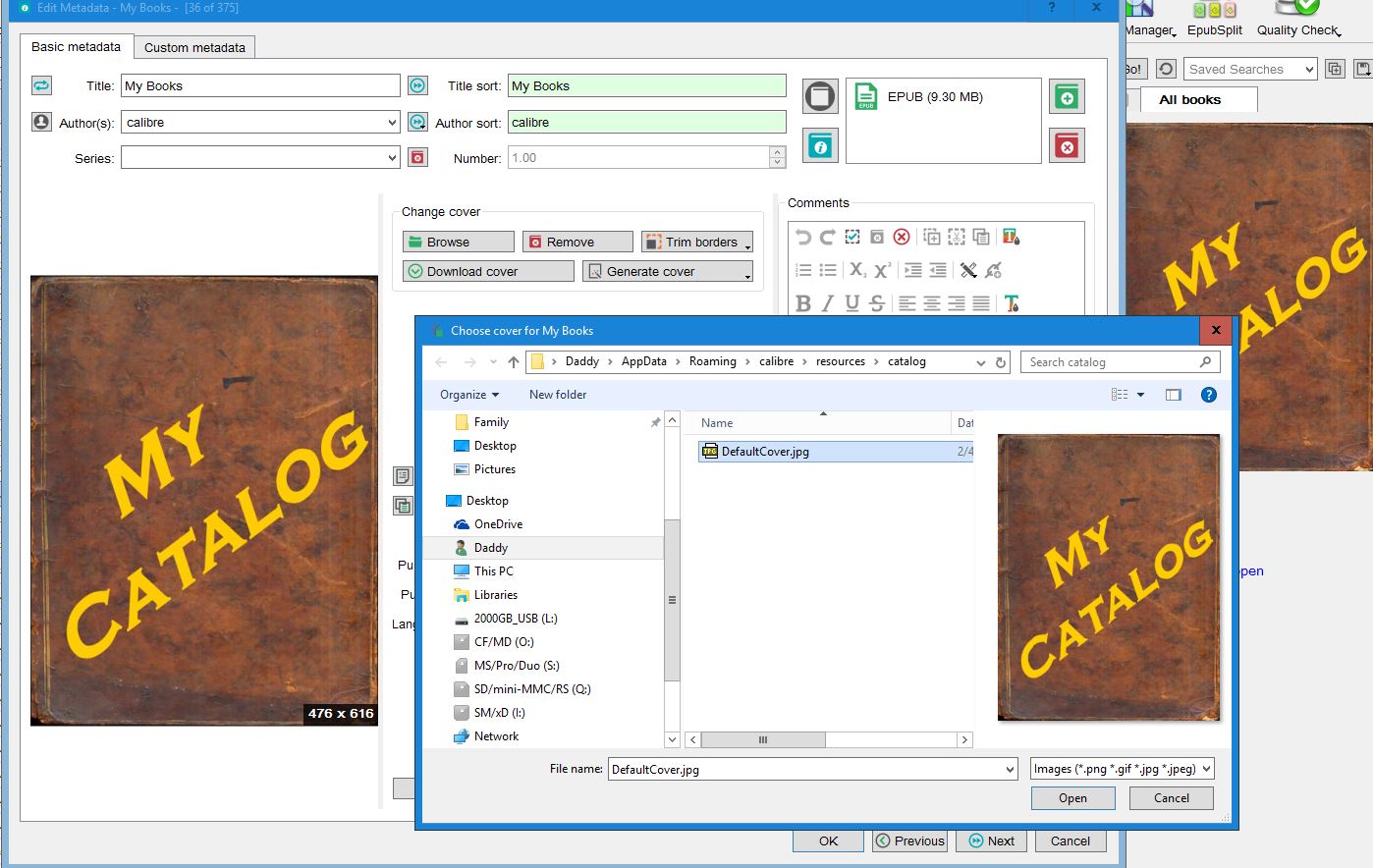

Since the catalog is just an epub in the calibre database with it's own metadata, etc. (screen shot), I had been in the (probably bad) habit of deleting the old catalog and then making a new one.
