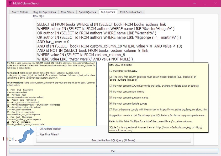

Version 1.0.43 - New: Raw SELECT SQL Query Tab
Version 1.0.43 - 12 February 2016 New: Raw SELECT SQL Query Tab
This new Tab only allows SELECT queries via the use of multiple validation rules prior to allowing execution to proceed.
Refer to the ToolTips on the new Tab for details. An image is attached below.
DaltonST

Version 1.0.44 - Raw SELECT SQL Queries & Keyword REGEXP
Version 1.0.44 - 16 February 2016 New: Raw SELECT SQL Queries can now use the SQLite Regular Expression keyword REGEXP.
Example:
SELECT id FROM books WHERE id IN (SELECT book FROM custom_column_8 WHERE value REGEXP '^.+$' )
DaltonST
