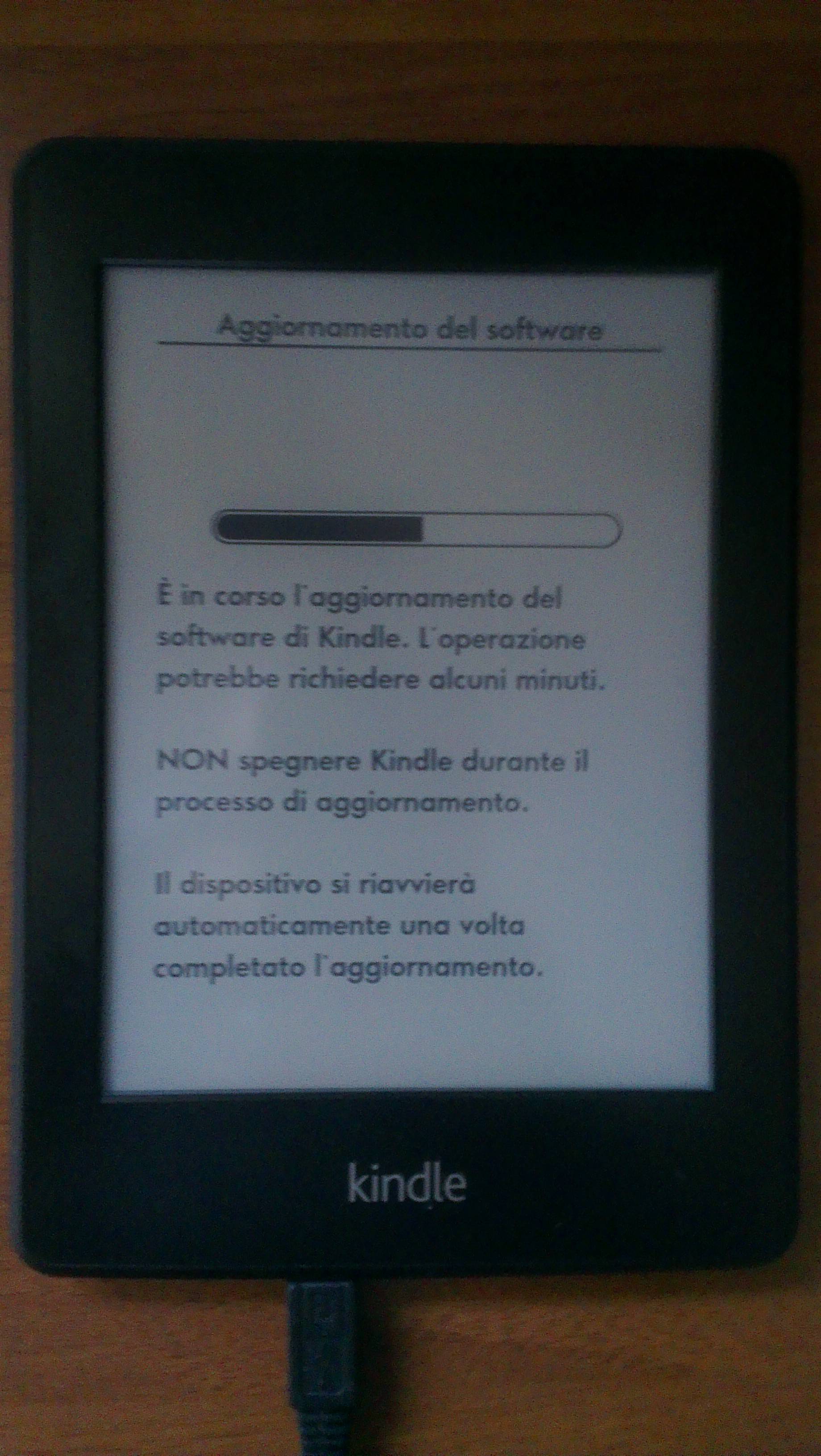

On the kindle I didn't do the JB and there aren't nothing important, so loosing the data is not a problem but I can't mount the partition, the kindle is always in the "upgrade state" when turned on, so when connected to the pc I don't see anything, even using lsusb.
I tried and I can only reboot it with the 30 seconds procedure.
The kindle is always in the state shown by the picture when turned on.

When you see the u-boot> prompt, just hit return -
u-boot will not do anything with a bunch of (for instance) j 's
Although your logs show that the update has successfully re-loaded the (main, 5.6.x) kernel image we will try the (old) diags kernel image.
Enter:
bootm 0xE41000
That should boot the (old) diags system.
I don't recall if the diags kernel trys to auto-update -
(That answer can be found in the logs attached to the recent fastboot recovery thread - I am too lazy to look it up.)
If it does try to auto-update, let it and hope it works.
OR
You might be looking at the 'recovery menu' now.
Let me know where we stand at this point.
Old 01-22-2016, 10:12 AM   #13
Whitefox
Whitefox began at the beginning.
Posts: 13
Join Date: May 2014
Device: kindle 4, kindle paperwhite
Thanks! Now finally I read what I type.
I did the "bootm 0xE41000" thing but it's trying to do the update and it's stuck again .
Whitefox is offline   Reply With Quote
Old 01-22-2016, 10:27 AM   #14
knc1
Going Viral
knc1's Avatar
Posts: 17,212
Karma: 18210809
Location: Central Texas
Device: No K1, PW2, KV, KOA
When you see:
INFO: task init:1 blocked for more than 120 seconds.
It isn't going to make any more progress, you mght as well re-boot it at that point.
do this (again):
uboot > bootm 0xE41000
and try to catch this one:
INFO:eink initialized... (786432 bytes)
Press [ENTER] for recovery menu...
(This time, just hold down 'enter' key. )
Note that the screen is initialized now.
This should be the 'recovery menu' (you may have to use the screen at this point - it just depends on the price of tea in China at the time this firmware was written).
You want the 'export USB' selection (usually the 'U' command listing).
Then plug the Kindle-to-PC USB cable in -
From the PC, delete any *.bin, *.dat files you find in USB storage -
eject -
remove cable -
reboot it -
(and keep it away from any source of update files !! )
# 88 88 - I'm too old for this shit!
Old 01-22-2016, 11:08 AM   #15
Whitefox
Posts: 13
Join Date: May 2014
I did all the procedure , I also saved my documents for precaution
But now i get an awful Kernel panic
