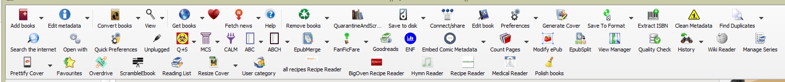

Has done an install of Calibre64bit and installed library codes. It works all fine. It creates the custom columns fine.... it appears only with the portable (downloaded from calibre site) i guest its 32bit version the portable.
The gui.json in the 64bit version shows the "Library Codes" in "action-layout-toolbar-device": [ , among others and
"library_codes:gui_parameters_dialog": {
"__class__": "bytearray",
"__value__": "AdnQywACAAAAAANOAAABIgAABR0AAAOOAAADVgAAAUEAAAUVA AADhgAAAAAAAAAAB4A="
whereas in the portable version the gui.json DON'T show any details about "Library Codes"
portable settings folider:
J:\PortableApps\Calibre\Calibre Settings\plugins
64bit version settings folder:
C:\Users\jemsoo7\AppData\Roaming\calibre
in the folder: J:\PortableApps\Calibre\Calibre Settings\plugins
there is no "Library Codes.json" but only the "Library Codes.zip" file....
could it be with the 32bit version or a permission issues on the DLL as i have put all different exe files compatibility: run as administrator in the J:\PortableApps\Calibre\Calibre folder.
i have installed most of the plugins from mobileread for testing purposes meanwhile all works fine (except a few like PrincePDF for linux). Photo is from the Portable Version...
