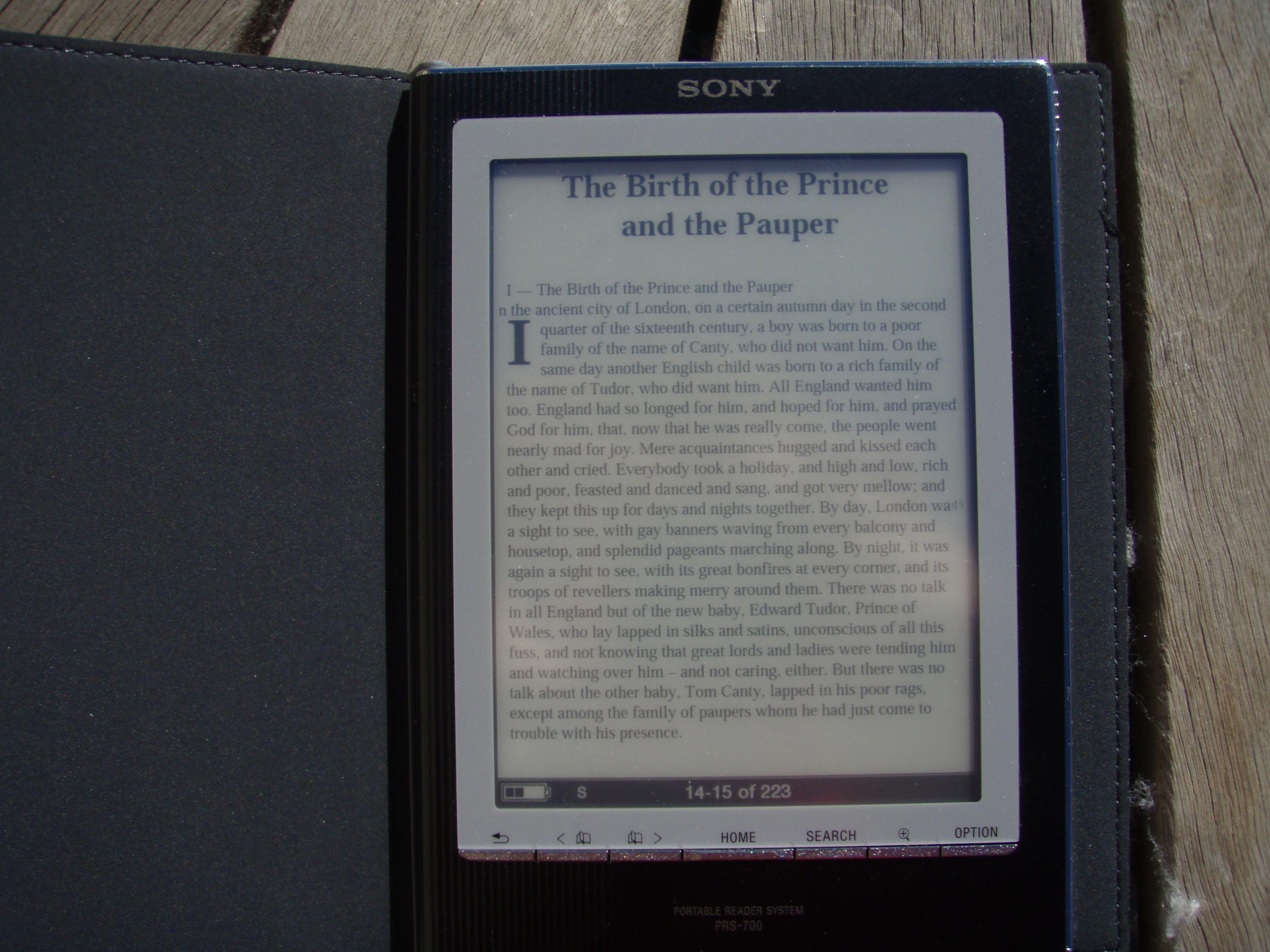

At least, I haven't seen it. Attached is what happens with this code:
css:
span.first {
font-variant: small-caps;
margin-left: -0.5em;
span.drop {
font-size: 400%;
font-weight: bold;
line-height: 0.75;
float: left;
margin: 0 0.125em 0 0;
xhtml:
<p><span class="first"><span class="drop">I</span>n</span> the ancient city of London...</p>
Now the idea that Sony needs to change their code-interpretation is probably indisputable, but who is going to call Sony and correct them? And then get them to distribute a fix? Or Adobe (DE has the same problem)?
C'mon, guys, prove me wrong. Oh, and showing something work in a browser on a computer doesn't count.
-bjc

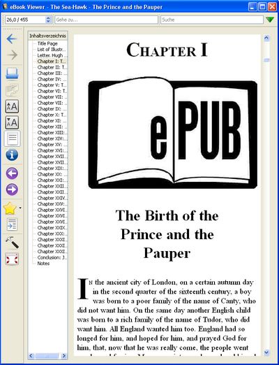

I don't have a Sony to try, but I'm the author of the ePUB example.
I'm pretty sure the problem is that the reader interprets "line-height: 0.75" by lowering the top "border", while browsers typically raise the whole "block" (the drop cap in this case).
I don't claim to be a CSS expert, far from it... I'm not even sure what the correct behaviour could be. Maybe I should add a "vertical-align: top" property? Could you try it?
What I'm sure it's doing wrong is rendering the "I - The Birth of the Prince and the Pauper" line, it should be ignored in the text flow (and, ideally, displayed as a page header from the next page).
Obviously you're right, Jellby. Sony uses the ADE rendering engine and we knew about this same problem as we have talked about it before. Sony, therefore, generally just reacts the way ADE does.

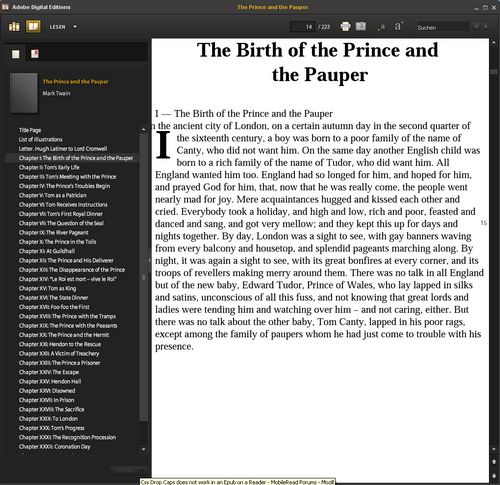

This is ADE. No changes I guess

Yes, and I tried unsuccessfully to install Calibre (and ADE in a virtual machine), so right now I don't have any real ePUB reader...
If you grab the stand-alone executable version of ADE, it actually runs perfectly fine under Wine.
Silly me, I thought a line-height with no units would be a multiple of the current line-height, not just ems...
Alas not... The difference between using ems vs. no units is that with no units cascaded elements will be that multiple of their font-size, no matter what the font size is. With ems, you fix the line-height to a particular measure which then doesn't change with changing font-sizes.
Well, I don't care that much that the drop-cap is an exact number of lines (and I'm reluctant to specify a line-height for normal text, that should be set by the reader)
I actually don't think it should be a problem as long as it's an em-based or unitless measure which varries with font-size. Because the spec doesn't specify an exact default value there isn't any other way to get pixel-perfect layouts.
For testing purposes, I'm uploaded the modified book (without illustrations, to reduce filesize), I'd be glad to see screenshots from Sony, ADE and Calibre...

Originally Posted by llasram View Post
However, playing around with it, I discovered that the culprit is the negative left margin on 'span.first'. I hesitate to theorize why ADE doesn't want to float the float before text which is pulled left of the left margin / into the box occupied by the float, but there you go.
Damn! So it's still Adobe's fault, but for a different reason. Now, what could be the solution?... Maybe combining "position: relative; right: 0.5em" and "margin-right: -0.5em" for span.first... but gosh! that's dirty hacking!
