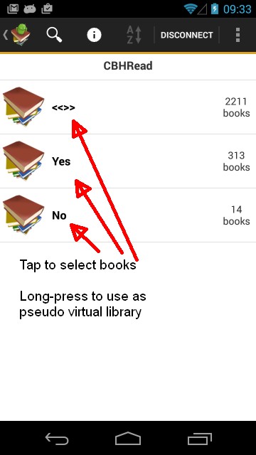

I'm going to jump on this thread as well.
I've been wondering is there a setting where I can filter the cloud libraries? And, if no, could it be added?
For example:
Only show those books that aren't marked in the "Read" Y/N column.

That is what the top-level display does -- allow you to select books with given values in some field. And if this isn't enough you can use the search function.
