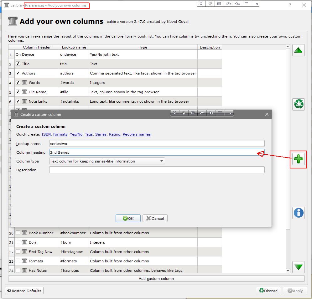

Shianelle - you shouldn't need to do any programming
First add a second series column, viz

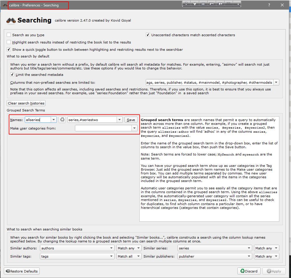

You can create a combined column for searching, viz
