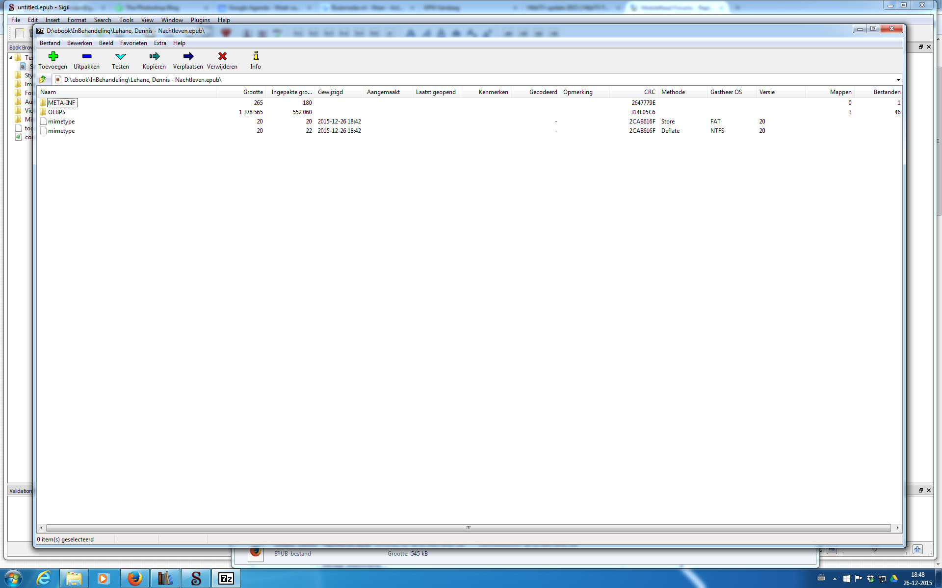

I would sure love to get an answer on whether or not any of these troublesome epubs show two mimetype files whenever listing the archive's contents. Because those are the ONLY epubs I've run into that validate (and are editable) by Sigil/calibre that ADE barfs on so far.

mimetype
I'am running Win7 Sigil 0.9.2 EpubCheck 0.3.4
Open an epub with Sigil
run EpubCheck
save the epub
Open the epub with 7-zip
and in my case you will find 2 mimetype files
PalingB is offline   Reply With Quote

And just about all versions of ADE/RMSDK hate that.
Thank you sooo much! It was driving me absolutely insane trying to nail this down. It happens when saving after running EpubCheck. It doesn't happen if you don't save, and it doesn't seem to happen when saving after running the Flightcrew (or any other) plugin. Now that we know "what" we can figure out "why" and how to fix it!
EDIT: ...and done. The Epubcheck plugin writes a new mimetype file to Sigil's scratch directory (bk._w.ebook_root). Suggested a fix in the plugin's thread.
Different things (including saving with calibre's editor) will apparently eliminate the extra mimetype file. I think we should probably try to make Sigil be able to self-correct something like this as well (and possibly figuring out a way to make the contents of bk._w.ebook_root downright inviolable by plugins).
I'd be very surprised if this wasn't the problem with your books @exaltedwombat.

There was a bug in my ePubCheck plugin that might have caused ePubs to be saved with two mimetype files if the epub was saved after running the ePubCheck plugin. I've uploaded a fixed version in the epubcheck plugin thread.
I'd strongly recommend re-saving all ePubs that you edited and saved immediately after running the ePubCheck plugin.
(Re-opening and re-saving ePubs with two mimetype files with Sigil 0.9.2 or Calibre Editor will automatically delete the extra mimetype.)
I'm really sorry for any inconvenience that this bug has caused you.
