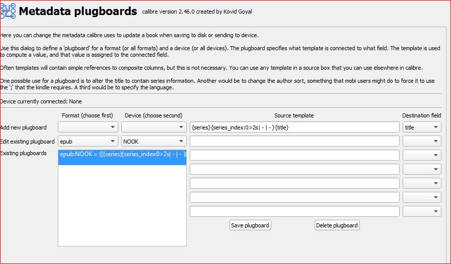

Why not attach some screen prints of the plugboards?

Old 12-24-2015, 03:50 PM   #10
Aliarides
Aliarides began at the beginning.
Posts: 14
Join Date: Dec 2015
Device: Nook
yes I did this :
o to the Nook's storage in your File Browser, and try opening one of the current books using calibre's "E-Book Viewer" or "Edit E-Book".
Just double-check that the new title was indeed written into the metadata of the copy of the book that was sent to the device.
and titles were not amended.
here is a screen shot from the plugboard option.
Aliarides is offline   Reply With Quote

Are you sure your device does use the NOOK driver?
Old 12-25-2015, 12:07 PM   #12
Posts: 31,561
Karma: 62543878
My thoughts exactly.
What does the bottom Status line show (as device) when the device is connected?
Old 12-25-2015, 02:56 PM   #13
eschwartz
Ex-Helpdesk Junkie
eschwartz's Avatar
Posts: 19,421
Karma: 85400180
Join Date: Nov 2012
Almost definitely a driver issue.
Personally I use Any Format :: Any Device.
There may be multiple Nook drivers, I cannot check at the moment since I am mobile. But I know there are multiple Kindle drivers -- the exact same confusion occurs when people try to use the KINDLE driver (for the Original Kindle ONLY) instead of the KINDLE2 driver.
Old 12-25-2015, 04:58 PM   #14
Posts: 31,561
Karma: 62543878
I see 3 output plugins for the Nook
The OP chose the most antique model
Old 12-25-2015, 09:21 PM   #15
davidfor
Posts: 24,905
Karma: 47303826
Location: Sydney, Australia
It should be the device driver, not output plugins. I can see two device drivers, the "NOOK" and "NOOK_COLOR". I have no idea which the "Nook Simple Touch" uses, but as you said, it should be shown when the device is connected.
