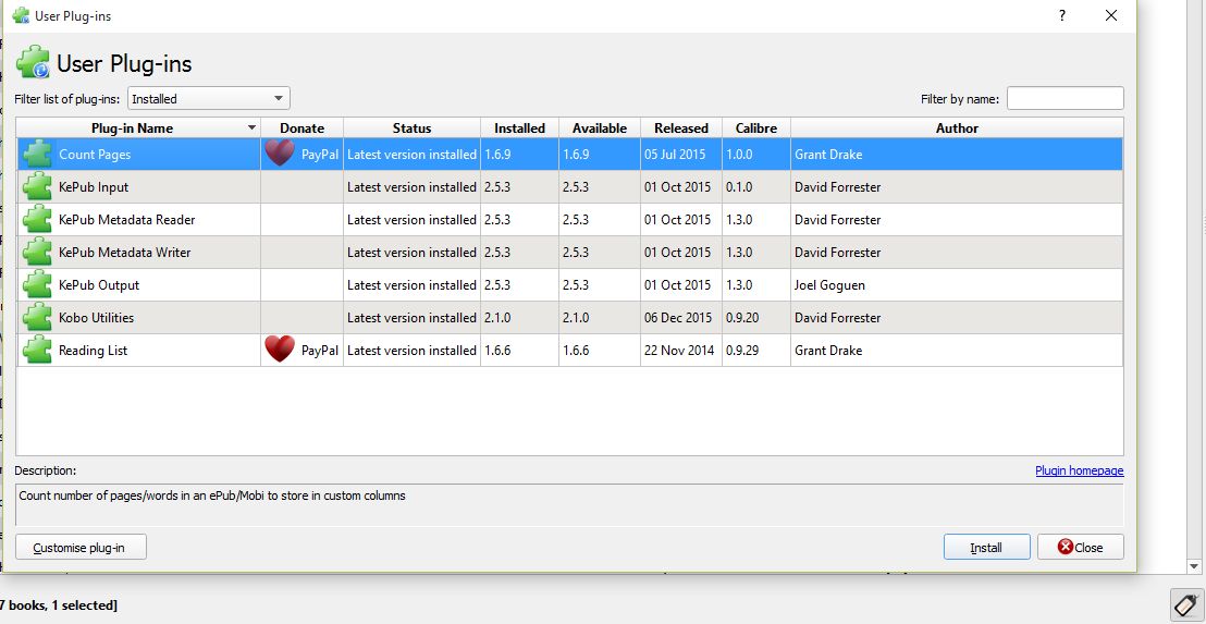

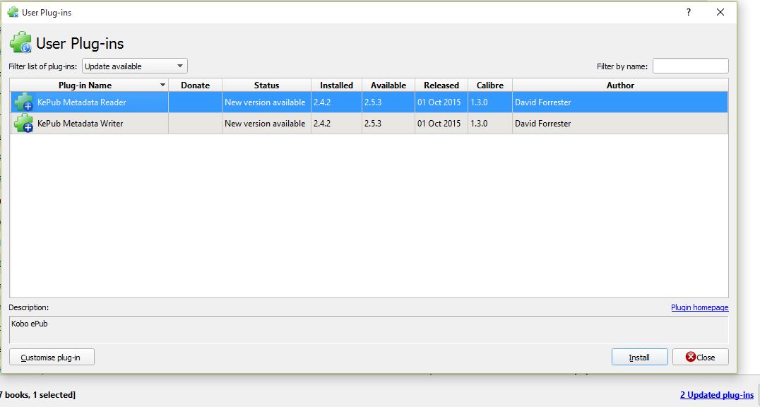

Right, 1st image is when I 1st opened Calibre, 2nd when I closed and reopened.
ID:	144751   Click image for larger version

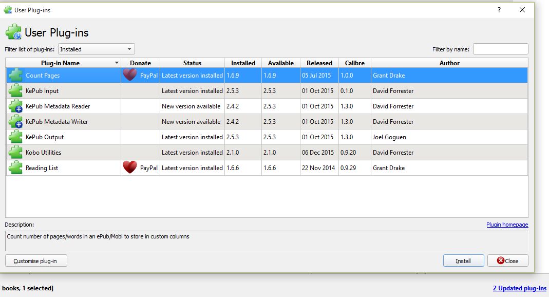

Still getting this on last startup
