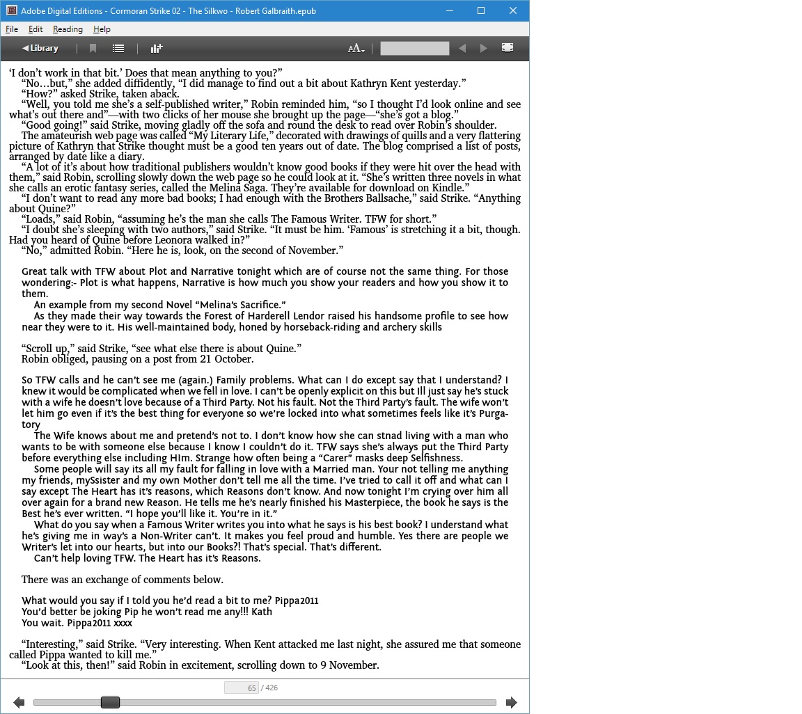

Big website-style gaps between paragraphs.
Unindented paragraphs.
Titles too large, always bold, with too small a top-margin.
Ugly for prose, a total mess for poetry.
That's more than enough ugliness for me, but perhaps not for you. You'll have to test that for yourself. But whenever I come across a book like that, I am a bit miffed.

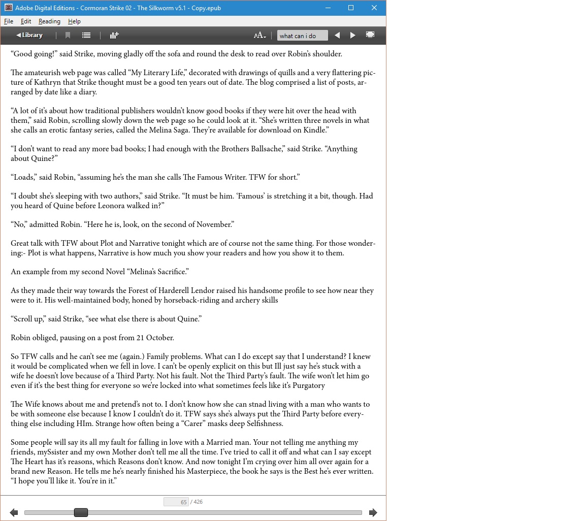

The first attached image shows the eBook with the CSS and the second image shows how bad it looks without CSS.
There is formatting that gets lost without CSS.
ID:	144792   Click image for larger version
