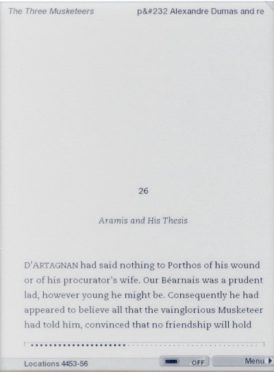

You may already know how this displays in the Kindle, but here are some scans of the screen. (Kindle's screenshot function wasn't working; not sure why.) I scanned @ 300dpi, then reduced the image, exported to JPG with 15% optimization, so the fuzziness is due to the scanning, not the screen itself.
On two of the images, I circled a portion of the author field that doesn't display properly. Also, I really like the way the chapters begin 1/2 way down the page & hope to get your CSS so I can apply it to the books I'm making.
Funny, it seems it takes the semicolon as a separator for different authors, and the comma as the separator between first and last name, so:
Alexandre Dumas, pè;re
(considering that the è entity is not decoded, it has a semiocolon then) is parsed as:
First author: pè (first name) Alexandre Dumas (last name)
Second author: re (last name)
I usually try to get something a bit more space-efficient...

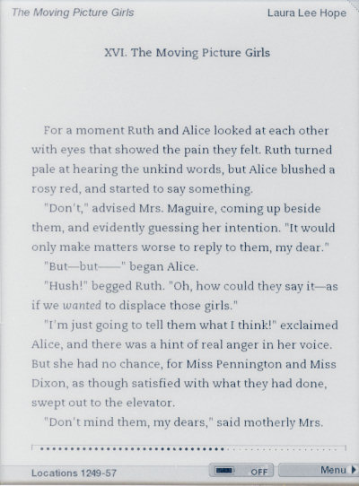

I'll agree that 1/2 the page is too far down, but I've not been happy with the default placement as shown in this first image (from The Moving Picture Girls). I also would like to try something like the pseudo-watermark used in the commercial book Fortune and Fate by Sharon Shinn as shown in the second image.
ID:	20771   Click image for larger version
