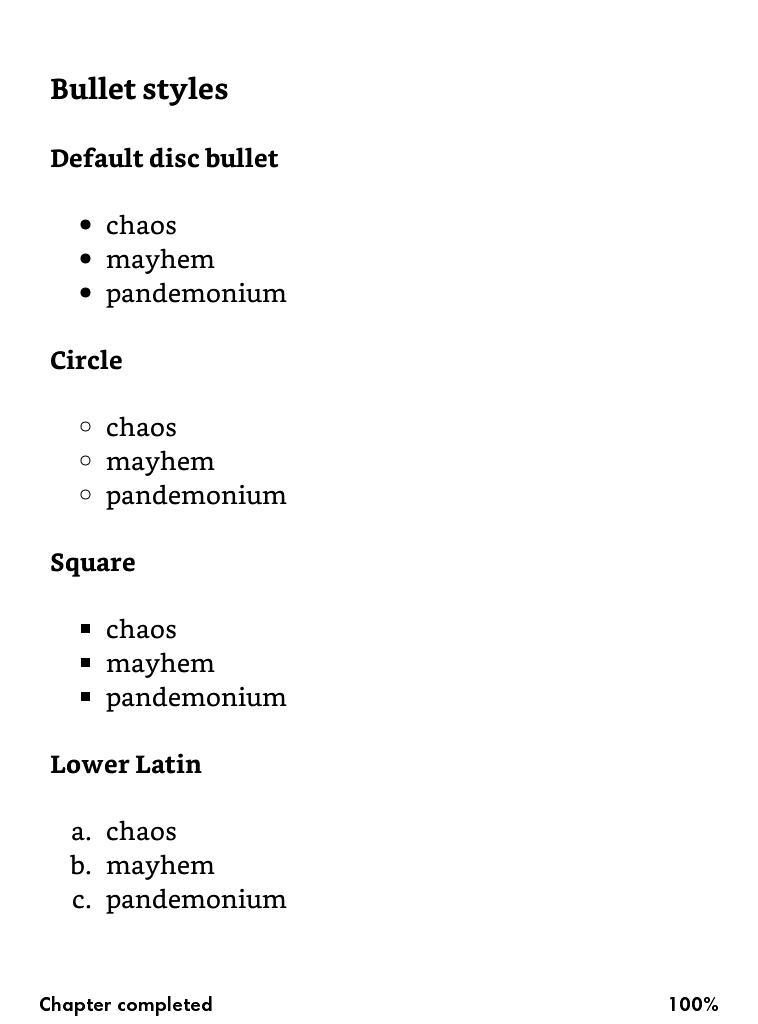

IMHO, hard-coding a bullet with &bull; is usually a bad idea, since Kindles support bullet styles in KF8 files and will default to disc bullets in KF7 files.
For example, you could use the following code:
<?xml version="1.0" encoding="utf-8"?>
<!DOCTYPE html PUBLIC "-//W3C//DTD XHTML 1.1//EN"
  "http://www.w3.org/TR/xhtml11/DTD/xhtml11.dtd">
<html xmlns="http://www.w3.org/1999/xhtml">
<head>
  <title></title>
  <style type="text/css">
	ul.circle {list-style-type: circle;}
	ul.square {list-style-type: square;}
	ul.latin {list-style-type: lower-latin;}
  </style>
</head>
<body>
  <h3>Bullet styles</h3>
  <h4>Default disc bullet </h4>
  <ul>
    <li>chaos</li>
    <li>mayhem</li>
    <li>pandemonium</li>
  </ul>
  <h4>Circle</h4>
  <ul class="circle">
    <li>chaos</li>
    <li>mayhem</li>
  </ul>
  <h4>Square</h4>
  <ul class="square">
    <li>chaos</li>
    <li>mayhem</li>
  </ul>
  <h4>Lower Latin</h4>
  <ul class="latin">
    <li>chaos</li>
    <li>mayhem</li>
  </ul>
</body>
</html>
Absolutely, There hasn't been a reason to use the bull code for years. Hell, there wasn't any reason to use it in 2009, if memory serves.
Yup, pretty as a picture.
