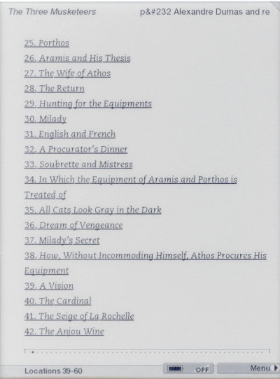

in the Kindle
You may already know how this displays in the Kindle, but here are some scans of the screen. (Kindle's screenshot function wasn't working; not sure why.) I scanned @ 300dpi, then reduced the image, exported to JPG with 15% optimization, so the fuzziness is due to the scanning, not the screen itself.
On two of the images, I circled a portion of the author field that doesn't display properly. Also, I really like the way the chapters begin 1/2 way down the page & hope to get your CSS so I can apply it to the books I'm making.
Awesome! Thank you . Looks pretty good... I may leave the cover generation at 600x800. Hmm...
Yarh... Already fixed. Although it looks like it's been re-arranged -- does the Kindle treat the ',' or '&' character specially, like trying to rearrange "Last, First" to "First Last"?
Funny, it seems it takes the semicolon as a separator for different authors, and the comma as the separator between first and last name, so:
Alexandre Dumas, pè;re
(considering that the è entity is not decoded, it has a semiocolon then) is parsed as:
First author: pè (first name) Alexandre Dumas (last name)
Second author: re (last name)
