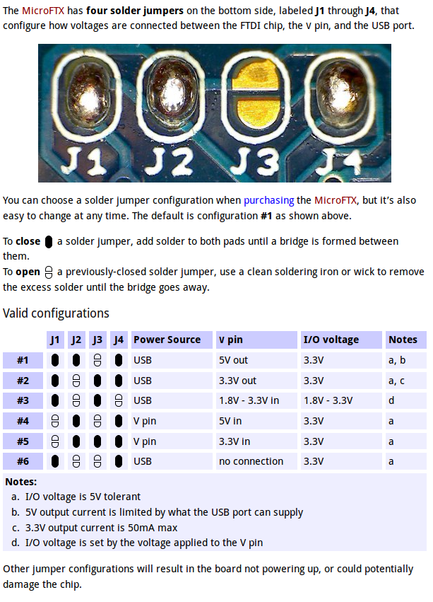

You have never mentioned which model of Kindle Paperwhite you have.
It makes a difference.
Use the device's first four (or first six) characters of its serial number and this table:
https://wiki.mobileread.com/wiki/Kindle_Serial_Numbers
to identify your model.
You have never mentioned what serial-to-usb adapter you are using.
Please post those details so that we do not give you the wrong directions.
Remember, we can not see over your shoulder.
You MUST give us details.
Old 12-01-2015, 09:14 AM   #100
jolunavi
jolunavi began at the beginning.
jolunavi's Avatar
Posts: 30
Join Date: Apr 2015
Device: Kindle paperwhite
Kindle_Serial_Number: 9017 22
Kindle PaperWhite 2 (2013) WiFi (4GB) (U.S., Intl.) PW2, PW2IL
What is the "serial-to-usb adapter"? ...sorry
maybe is this? http://imgur.com/xFAgmMZ
jolunavi is offline   Reply With Quote
Old 12-01-2015, 09:25 AM   #101
knc1
Going Viral
knc1's Avatar
Posts: 17,212
Karma: 18210809
Location: Central Texas
Device: No K1, PW2, KV, KOA
Yes.
That is the device and the hook-up to use, for the PW-2.
Important!
That picture shows the option jumpers not set for 1v8 interface, although it does show the reference voltage input hooked up.
That photo was originally posted at this site and the text of the post mentioned that the jumpers where not set properly when the photo was taken.
For the connections shown -
Remove jumper J2 -
Add jumper J3 -
See attachment (configuration #3).

ok, I did!
http://imgur.com/tNiQvps
....and now?
