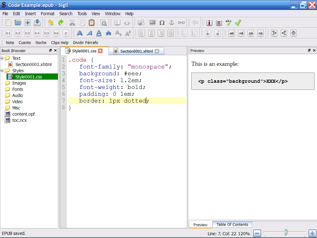

Do the following:
1. In your .xhtml file write:
<div class="code">
    <pre>
         &lt;p class="background"&gt;XXX&lt;/p&gt;
    </pre>
</div>
2. In your .css file write:
.code {
   font-family: "monospace"; /* This wouldn't be necessary if you use the <pre> tag but... */
   background: #eee;
   font-size: 1.2em; /* change the font size if you wish */
   font-weight: bold; /* change this to normal if you wish */
   padding: 0 1em;
   border: 1px dotted;
This is how it looks in Sigil:
Below I attach the respective epub so you can understand better all the things.
Regards
Rubén
