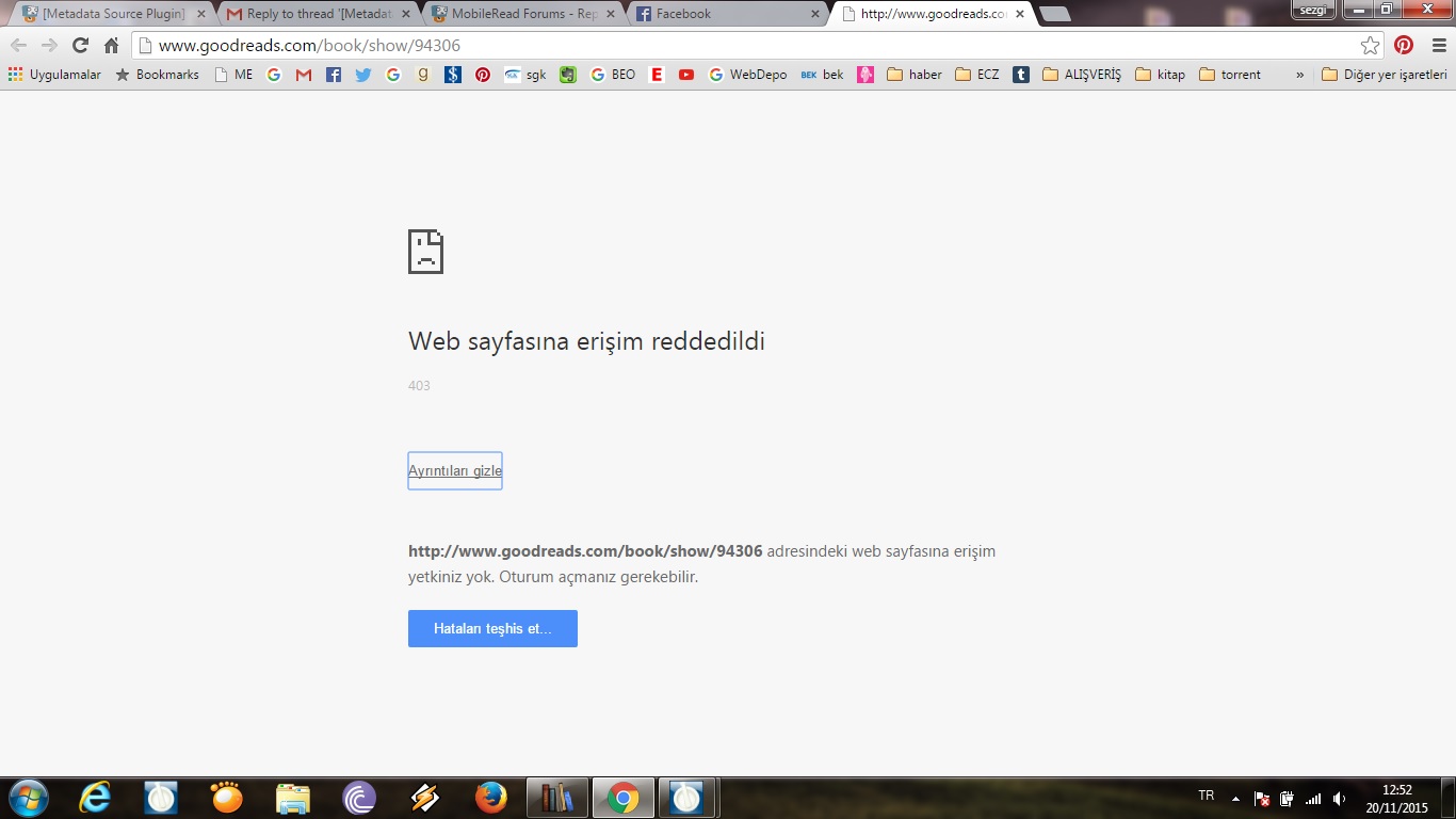

when I click link I'm getting this page. It means 'Access denied to the Web page. You are not authorized.You may need to login.'
I try everything one book, bulk download, re*download calibre, re-download plugin, change browser, change my goodreads user settings.
When I click to link sometimes link begining with http://, sometimes https://
I think I can't solve this problem

Firstly, the URL that calibre builds for Goodreads is HTTP. But, Goodreads is redirecting that to HTTPS. Or at least it is here.
If the error is happening in the browser, it probably means it is something in your connection. That error page doesn't look like it comes from Goodreads. Do you have a proxy between you and the web that you need to login to? Can you reach the Goodreads home page? Is using HTTPS different to HTTP?
