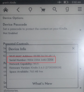

1. Your kindle! And its serial #.
Write that down. (apparently you should hide your serial #. So i've hidden part of mine. Come @ me, haxors!)

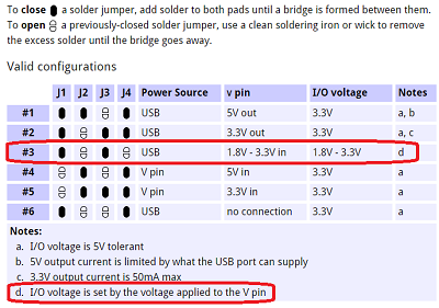

2. USB -> Serial converter board.
This is what most people use: Jim's Board because it's cheap & does the job.
You want to specifically order option #3. This is necessary because your kindle uses 1.8v signals and if you use 3.3v or 5.0v, you can blow up your chips.
Name:	jb-02-ftx configuration.png

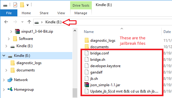

  • "K5 Jailbreak (5.0.x - 5.4.4.2)" Software. This is what unlocks the power! (The jailbreak software was recently updated to behave better for our serial jailbreaks, so we are going to download the latest version from NiJuLe's daily snapshot thread instead of getting the older version from the Jailbreak thread.) (thanks NiJuLe!)
    Hint: Use "7-Zip" or "WinRar" to unpack the jailbreak software.
  • Kual AND Kual Helper This runs the goodies you want to install. (thanks twobob!)
  • MRPI You need this to install those goodies. (thanks NiLuJe!)
  • Screensaver hack we'll install this to confirm the jailbreak worked. (thanks NiLuJe!)

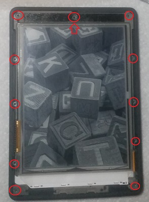

2. Remove the screws
There are 11 screws. The one in the middle is hidden underneath adhesive tape- don't miss it!
Tiny screws are like children! They love to play hide & seek! So make sure you put them immediately into your previously-obtained plastic container so have no chance to escape your merciless screwdriver.
Name:	jb-04-remove screws.jpg

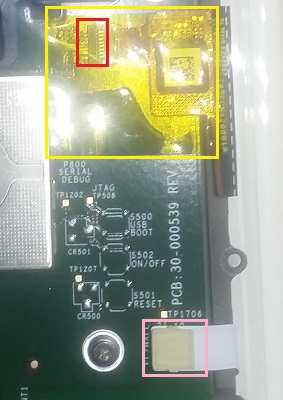

4. Unhook cables
1st cable:
You don't want your delicate fragile cables getting in the way of mean mr. soldering iron
  • Peel back the tape (Yellow)
  • Lift the tiny lever that holds the cable in place (Red)
  • Pull out the cable
  • Wrap the tape & cable behind the screen
2nd cable
  • Lift the cable out from its socket (Pink)
  • Wrap the cable behind the screen
Name:	jb-06-undo cables.jpg

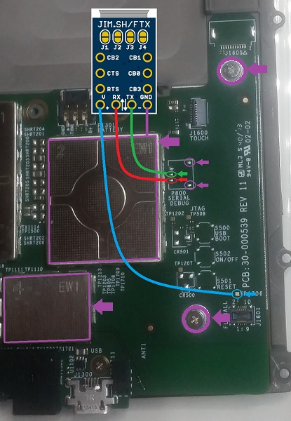

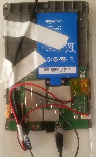

5. Connect the USB converter board!
Use your soldering tools to do this work. You need to make these 4 connections:
Converter	Kindle Board	On Diagram
V 	  	TP1706 		Blue Arrow
GND 	  	(Any Ground) 	Purple Arrows
RX 	  	Left Serial 	Red Arrow
TX 	  	Center Serial 	Green Arrow
Hint: You can connect to any of the possible ground points. The metal plates are very convenient
Name:	jb-07-serial connection points.jpg
Here is a close-up of my own soldering adventure:
Name:	jb-09-closeup of solder points.jpg
6. Reconnect screen and battery
Your kindle needs powah...! Reconnect:
  • Screen cables
  • Battery
  • Plug USB Serial converter into your computer
  • Plug Kindle into your computer
I have taped my USB board to the frame because my soldering skills are weak and I didn't want to risk pulling things loose as I moved it around.

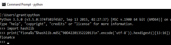

1. Get your Kindle's password

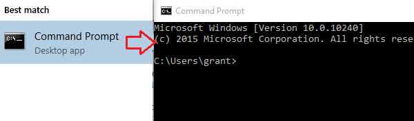

Python can magically turn your serial number into your kindle's password. We will need the password to do tricky things with it.
Open a command prompt
Name:	jb-12-command prompt.png
Run "Python" and execute these commands:
import hashlib
print("fiona%s"%hashlib.md5("
<your kindle serial number with no spaces and all capital letters>\n".encode('utf-8')).hexdigest()[13:16])
Name:	jb-13-get password.png
What pops out is your root password! "fionaxxx"
Hint: If you cannot run python it means you did not install it properly

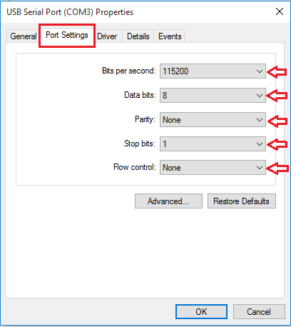

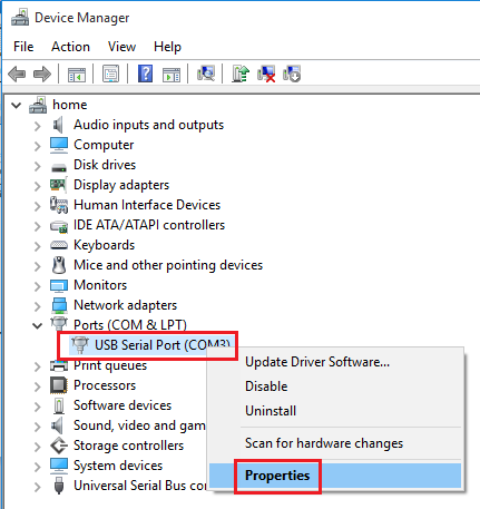

2. Set up your COM port
Now we need configure your computer to talk to the USB converter board.
Plug board into your computer.
Open "Device Manager" and find the "USB Serial Port (COM3)" item which is now available
Hint: If this device isn't showing in windows, it means you didn't install the drivers correctly!
Right-click the item and edit its properties
Name:	jb-10-USB Serial device.png

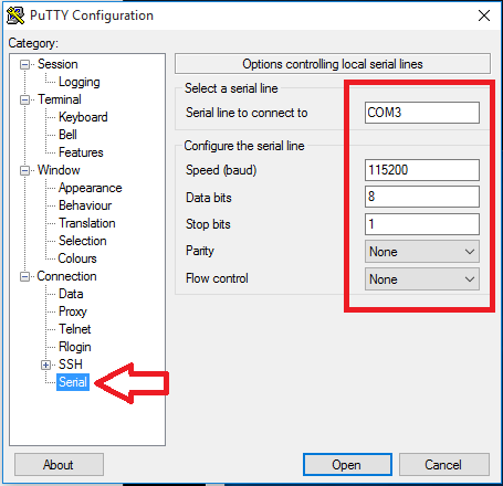

Click "Port Settings" and set everything like below:
Name:	jb-11-port settings.png

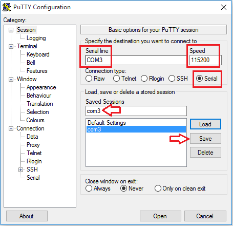

3. Set up PuTTy
Putty is the program that will talk to your kindle. Open the program, create, and save a new connection with these settings:
- Connection Type = "Serial"
- Serial line = "COM3" or whatever COM # this shows up as in device manager
- Speed = "115200"
Name:	jb-14-putty setup1.png
Navigate to "Connection" -> "Serial" and set up the options to match what you set up in device manager
Name:	jb-15-putty setup 2.png

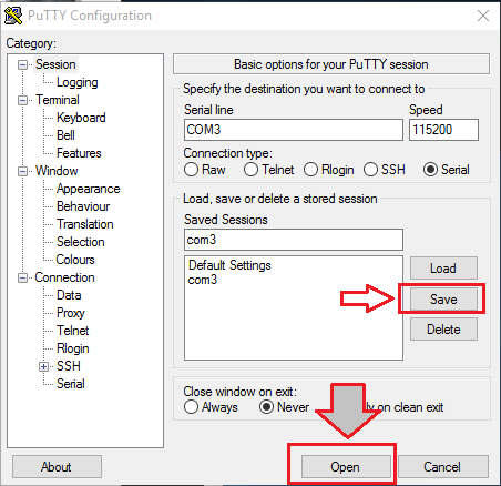

Save the session again (sometimes putty forgets stuff...) and then open the session:
Name:	jb-16-putty setup 3.png

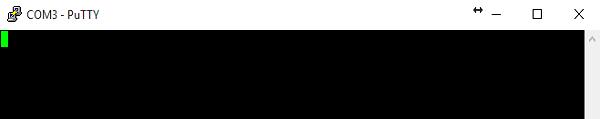

A new blank, black window will appear. This is the window which lets us talk to the kindle.
Name:	jb-17-blank putty window.png

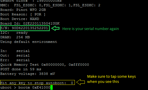

1. Get into the diagnostics boot
Turn on your kindle, and watch the blank putty window you have open.
As soon as text starts appearing in the window, begin tapping keys on your keyboard.
Text will keep scrolling until the boot is interrupted
Hint: If you you miss the chance to interrupt, and your kindle starts normally, you can "restart" your kindle from its menus and try again
Once the booting is interrupted, the screen will say "uboot >", type this command: bootm 0xE41000

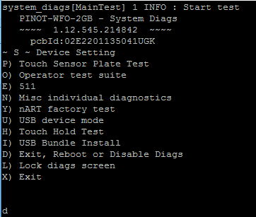

This makes the kindle boot to "diagnostics", which is a place where we can unlock access to the main kindle stuff.
When the diags menu displays, type "d"
Name:	jb-19-diag boot menu 1.png

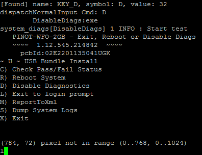

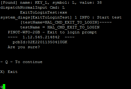

On the next menu type "l" ("L")
Name:	jb-20-diag boot menu 2.png

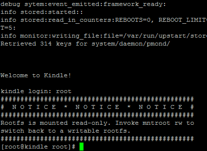

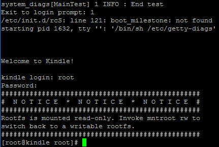

Enter these login credentials:
kindle login: root
password: <the password you got from running python, e.g. fionaxxx>
Hint: the password won't show on the screen while you are typing it
Hint: If the password isn't working, you probably copied down your serial # incorrectly. You can cut & paste the serial number from your putty window into the python command and run it again to get the correct password.
Name:	jb-22-boot diag enter credentials.png
you are now logged in!

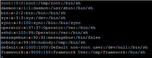

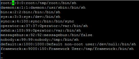

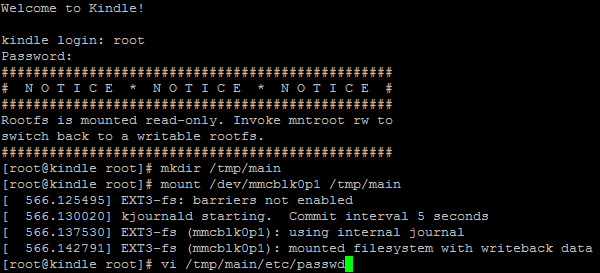

2. Edit the password file
vi is a funny little program that edits text files. Linux users prefer to use confusing programs so they can keep dummies like us out of their way... but in this case I'll show you how to sneak through
Run these 3 commands to edit the password file:
mkdir /tmp/main
mount /dev/mmcblk0p1 /tmp/main
vi /tmp/main/etc/passwd
The Vi program will load and put the password file on the screen
Use the arrow keys to move the cursor over the "x" (it might be a "!" instead) which is right after "root:".
Press "x" to delete the x
Hint: The "delete" key doesn't actually delete characters in this program. Just roll with it.
The file now looks like this
Removing the "x" is telling the system that the main root account doesn't need a password.
Type ":w" to save the file & exit the editor
The text editor will close, but the file will still appear on the screen. Don't be afraid of that, it's ok.
Type "reboot" to restart the kindle

In your putty window, press "Enter" This will display the login prompt
Type root to log in
Name:	jb-29-log in as root.png

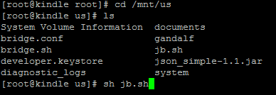

Type these 2 commands:
cd /mnt/us
sh jb.sh
Name:	jb-30-Run jailbreak command.png

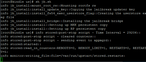

The jailbreak will do its business
Name:	jb-31-Jailbreak finished.png

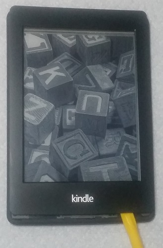

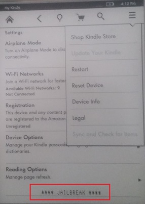

Hint: If you are watching the screen, you will see the word "**** JAILBREAK ****" appear at the bottom
Name:	jb-31b-Jailbreak finished - screen.jpg

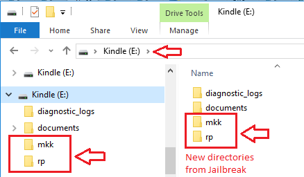

Plug your kindle into the computer and look at the Kindle storage in windows
You will see new directories have been made by the jailbreaking
Name:	jb-33-New jailbreak directories.png

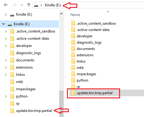

4. Protect your jailbreak
Amazon is sneaky, even sneakier than those tiny little screws which will try to escape your tupperware! If we are not careful, they will secretly upload new software to your kindle and ruin everything!
Hint: Keep your kindle in "airplane mode" all the time. This keeps your precious device safe from Amazon poking at it.
BUT: If you must connect to the internet (e.g., to register your device) We will also set up a little protection to make sure no updates are snuck in under your nose
On your kindle create a new directory called: "update.bin.tmp.partial"
Name:	jb-33b-protection directory.png
This directory will confuse silly Amazon and stop them from uploading any software
Congratulations! You are now Jailbroken!

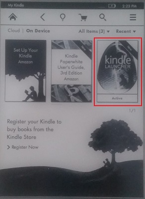

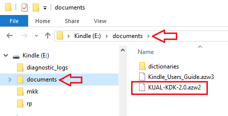

1. Install KUAL
KUAL provides a GUI to manage other programs on your kindle
Copy the "azw2" file from the KUAL zip to the "Documents" directory of your kindle
Name:	jb-34-Kual file dropped.png
Eject the kindle from your computer
"Restart" your kindle from the screen menu
When your kindle is restarted, you will see the "Kindle Launcher" is now available
Name:	jb-35-KUAL installed.jpg

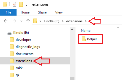

2. Install KUAL Helper
This helps KUAL be better than ever. (I think it lets your goodies appear in the KUAL menus)
Connect your kindle to your computer
Copy the "Helper" directory from the KUAL Helper zip into the "Extensions" directory on your kindle
Name:	jb-36-Helper files installed.png
Hint: I am not certain that ejecting & restarting the kindle is necessary, but I do it anyways

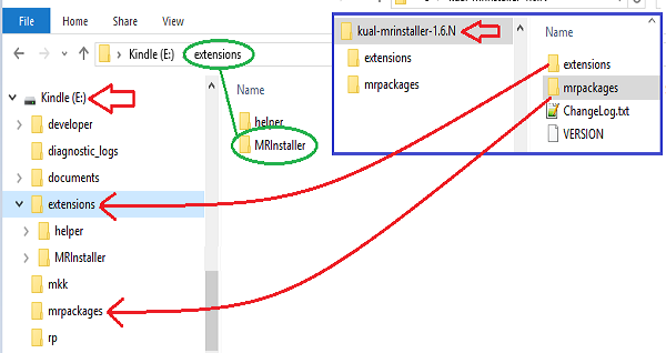

3. Install KUAL MRInstaller
This is an add-on for KUAL that allows add-on packages to be installed very easily. I think it needs KUAL helper which is why we are doing it 3rd
Copy the 2 directories from the MRInstaller zip to the root of your kindle.
This means a new directory called "MRInstaller" will be created inside extensions, and another directory called "mrpackages" will be created in the root"
Name:	jb-37-install MRInstaller.png

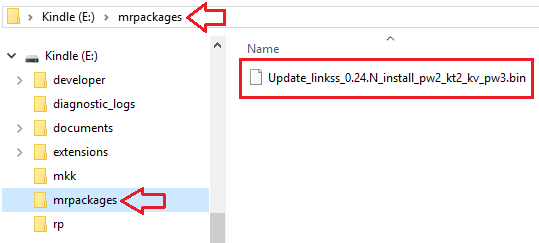

4. Install Screensaver hack
This will let you change which screensavers appear when your kindle is sleeping. Perfect to show your spouse, children, pets, or cars that they super special to you!
Copy the .bin file from the Screensaver Hack .ZIP to the "mrpackages" directory on your kindle
Name:	jb-38-Install SS hack.png

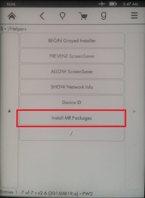

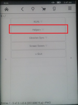

Open the "Kindle Launcher" (KUAL) book on your kindle
Select "Helper+" menu option
Select "Install MR Packages" menu option
Name:	jb-40-Install MR Packages.jpg
The MR Installer program will do some stuff and will tell you when it's done
