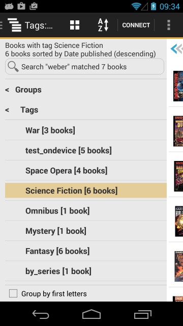

The following screenshots show CC with a search and sort active.

When I go from CC to the desktop using the "Home" button then tap the CC icon, I see the second screen again.
Although I know of no case where grouping and sorting will get lost, there is one case where the search will get not be re-applied. If the device is severely memory challenged then the search results might be gone when CC restarts. Because search can be very slow, CC does not automatically redo the search. Instead it remembers what it was. You can tap the search line and redo it by hand. As the grouping and sorting values were remembered, what you see after redoing the search is very close to what was showing before tapping "Home".

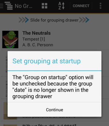

CC now shows this dialog if the "grouping on startup" group no longer is in the grouping drawer.
