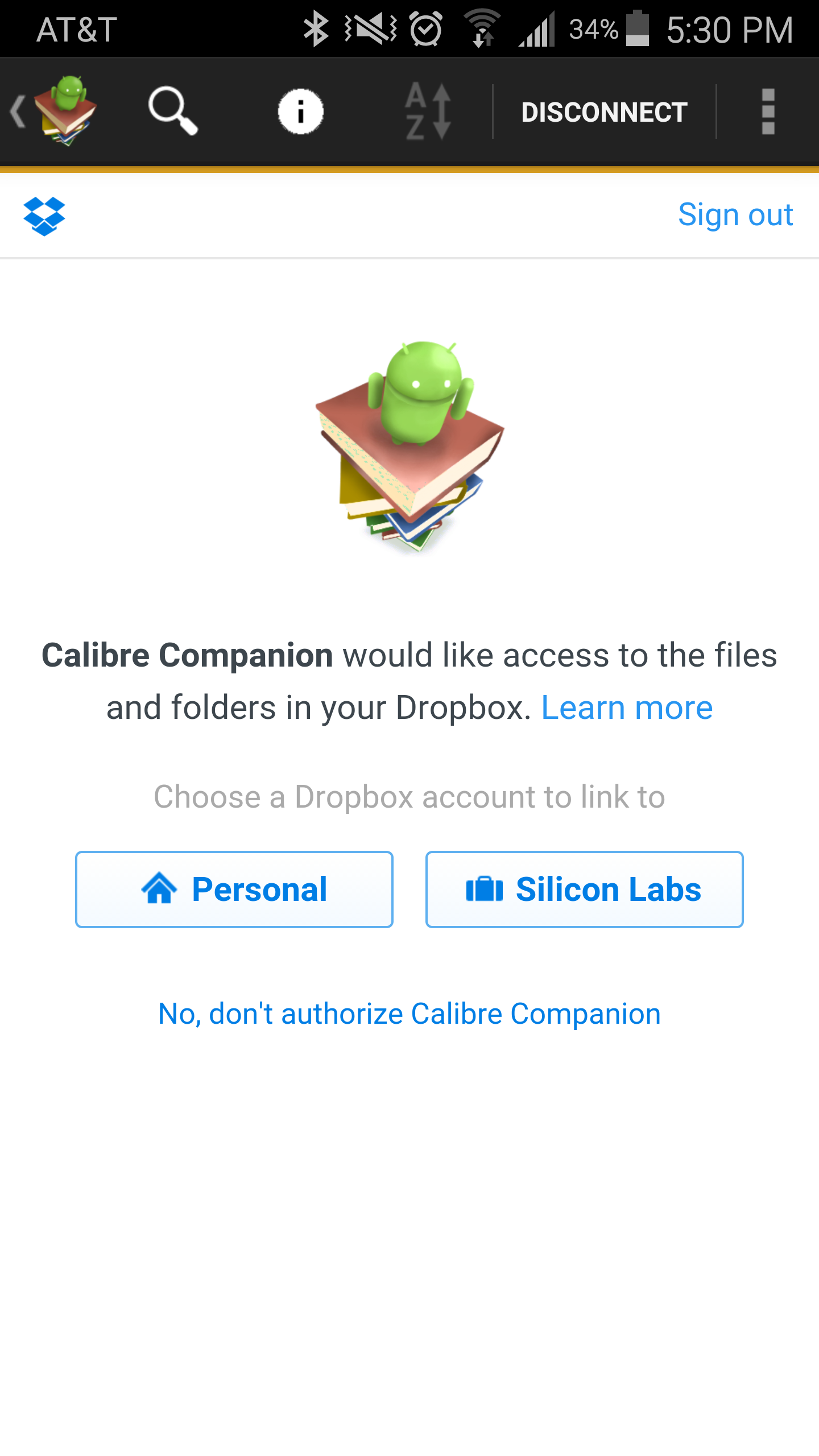

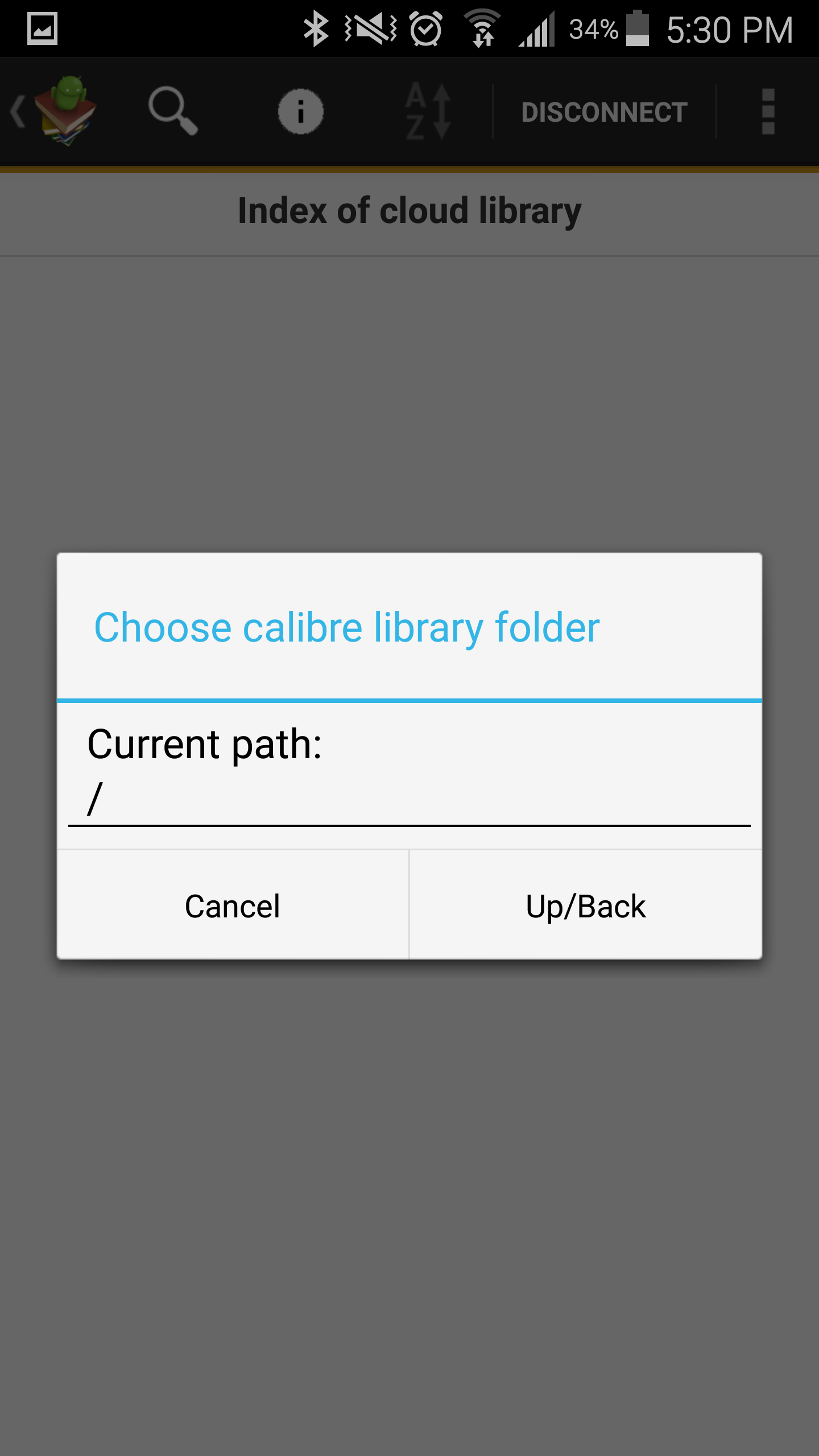

Problem selecting the Dropbox library folder
I have the latest (paid) version of CC installed on my Samsung Galaxy Note 4 running Android 5.1.1. I am trying to access my Calibre library in Dropbox. The whole Dropbox authentication process works fine, but when I get to the step where I have to chose the folder, after some crunching, I just get the "/" option and from there I can only do cancel or back, so I cannot select any library folder.
I have the identical issue on my samsung Tab S with same version of the SW and Android.
The only special thing is that I have my business Dropbox account linked to the personal one. I wonder if that is the problem. For instance, I know that after I did the link, my notebook now contain 2 folder and the personal got renamed from "Dropbox" to "Dropbox (personal)". Could it be a folder name issue?

The linked accounts could be causing the problem. The dropbox documentation is very vague about how it is supposed to work, and I can't test it.
Assuming that your library is in the "Personal" dropbox, from what I understand from the documentation things should work if you tap the "Personal" button. That is supposed to connect CC to the personal account as if the other linked accounts did not exist. At that point you should see the folders, which clearly is not happening in your case.
One point: CC will work only if the calibre library is in a subdirectory in dropbox, not in the root. In other words, the metadata.db file must not have the name /metadata.db, but instead have a name like /something/metadata.db.
