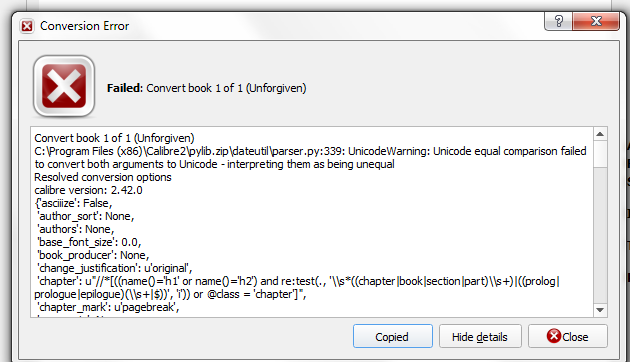

How to convert to kepub?
Hey, I'm trying to convert some books to .kepub for my Kobo Aura in Calibre, but it fails. I've installed plug-ins specially designed for it. I had success doing it manually by renaming the books with the kepub.epub file extension. So, how can I do that with Calibre?
Mike the best is offline   Reply With Quote

No one here is clairvoyant. Could you maybe help us by describing what fails, posting error messages and logs?
I have installed the KePub Metadata Reader, the KePub Metadata Write and the KePub Outputs plug-ins. Then I try to convert the books and an error message appears. It's attached below.
Also this is the text that shows at the message: calibre, version 2.42.0 (win32, isfrozen: True)
Conversion Error: Failed: Convert book 1 of 1 (Unforgiven)
C:\Program Files (x86)\Calibre2\pylib.zip\dateutil\parser.py:339: UnicodeWarning: Unicode equal comparison failed to convert both arguments to Unicode - interpreting them as being unequal
Resolved conversion options
calibre version: 2.42.0
{'asciiize': False,
'author_sort': None,
'authors': None,
'base_font_size': 0.0,
'book_producer': None,
'change_justification': u'original',
'chapter': u"//*[((name()='h1' or name()='h2') and re:test(., '\\s*((chapter|book|section|part)\\s+)|((prolog|pr ologue|epilogue)(\\s+|$))', 'i')) or @class = 'chapter']",
'chapter_mark': u'pagebreak',
'comments': None,
'cover': u'C:\\Users\\C376~1\\AppData\\Local\\Temp\\calibre _cn6obl\\q6dwod.jpeg',
'debug_pipeline': None,
'dehyphenate': True,
'delete_blank_paragraphs': True,
'disable_font_rescaling': True,
'dont_split_on_page_breaks': False,
'duplicate_links_in_toc': False,
'embed_all_fonts': False,
'embed_font_family': None,
'enable_heuristics': False,
'epub_flatten': False,
'epub_inline_toc': False,
'epub_toc_at_end': False,
'expand_css': False,
'extra_css': None,
'extract_to': None,
'filter_css': u'',
'fix_indents': True,
'flow_size': 260,
'font_size_mapping': None,
'format_scene_breaks': True,
'html_unwrap_factor': 0.4,
'input_encoding': None,
'input_profile': <calibre.customize.profiles.InputProfile object at 0x04E6BF70>,
'insert_blank_line': False,
'insert_blank_line_size': 0.5,
'insert_metadata': False,
'isbn': None,
'italicize_common_cases': True,
'keep_ligatures': False,
'kepub_clean_markup': True,
'kepub_disable_hyphenation': False,
'kepub_hyphenate': True,
'kepub_replace_lang': True,
'language': None,
'level1_toc': None,
'level2_toc': None,
'level3_toc': None,
'line_height': 0.0,
'linearize_tables': False,
'margin_bottom': 5.0,
'margin_left': 5.0,
'margin_right': 5.0,
'margin_top': 5.0,
'markup_chapter_headings': True,
'max_toc_links': 50,
'minimum_line_height': 120.0,
'no_chapters_in_toc': False,
'no_default_epub_cover': False,
'no_inline_navbars': False,
'no_svg_cover': False,
'output_profile': <calibre.customize.profiles.KoboReaderOutput object at 0x04E713B0>,
'page_breaks_before': u"//*[name()='h1' or name()='h2']",
'prefer_metadata_cover': False,
'preserve_cover_aspect_ratio': False,
'pretty_print': True,
'pubdate': None,
'publisher': None,
'rating': None,
'read_metadata_from_opf': u'C:\\Users\\C376~1\\AppData\\Local\\Temp\\calibre _cn6obl\\hznso8.opf',
'remove_fake_margins': True,
'remove_first_image': False,
'remove_paragraph_spacing': False,
'remove_paragraph_spacing_indent_size': 1.5,
'renumber_headings': True,
'replace_scene_breaks': u'',
'search_replace': '[]',
'series': None,
'series_index': None,
'smarten_punctuation': False,
'sr1_replace': None,
'sr1_search': None,
'sr2_replace': None,
'sr2_search': None,
'sr3_replace': None,
'sr3_search': None,
'start_reading_at': None,
'subset_embedded_fonts': False,
'tags': None,
'timestamp': None,
'title': None,
'title_sort': None,
'toc_filter': None,
'toc_threshold': 6,
'toc_title': None,
'unsmarten_punctuation': False,
'unwrap_lines': True,
'use_auto_toc': False,
'verbose': 2}

Splitting on page-break at id=calibre_pb_34
Adjusted split point to ancestor
Splitting on page-break at id=calibre_pb_35
Splitting on page-break at id=calibre_pb_36
Splitting on page-break at id=calibre_pb_37
Splitting on page-break at id=calibre_pb_38
Splitting on page-break at id=calibre_pb_39
Splitting on page-break at id=calibre_pb_40
Splitting on page-break at id=calibre_pb_41
Splitting on page-break at id=calibre_pb_42
Splitting on page-break at id=calibre_pb_43
Splitting on page-break at id=calibre_pb_44
Splitting on page-break at id=calibre_pb_45
Splitting on page-break at id=calibre_pb_46
Splitting on page-break at id=calibre_pb_47
Splitting on page-break at id=calibre_pb_48
Splitting on page-break at id=calibre_pb_49
Splitting on page-break at id=calibre_pb_50
Splitting on page-break at id=calibre_pb_51
Splitting on page-break at id=calibre_pb_52
Splitting on page-break at id=calibre_pb_53
Splitting on page-break at id=calibre_pb_54
Splitting on page-break at id=calibre_pb_55
Splitting on page-break at id=calibre_pb_56
Splitting on page-break at id=calibre_pb_57
Splitting on page-break at id=calibre_pb_58
Splitting on page-break at id=calibre_pb_59
Splitting on page-break at id=calibre_pb_60
Splitting on page-break at id=calibre_pb_61
Splitting on page-break at id=calibre_pb_62
Splitting on page-break at id=calibre_pb_63
Splitting on page-break at id=calibre_pb_64
Splitting on page-break at id=calibre_pb_65
Splitting on page-break at id=calibre_pb_66
Splitting on page-break at id=calibre_pb_67
Splitting on page-break at id=calibre_pb_68
Splitting on page-break at id=calibre_pb_69
Splitting on page-break at id=calibre_pb_70
Splitting on page-break at id=calibre_pb_71
Splitting on page-break at id=calibre_pb_72
Splitting on page-break at id=calibre_pb_73
Splitting on page-break at id=calibre_pb_74
Splitting on page-break at id=calibre_pb_75
Splitting on page-break at id=calibre_pb_76
Splitting on page-break at id=calibre_pb_77
Splitting on page-break at id=calibre_pb_78
Splitting on page-break at id=calibre_pb_79
Splitting on page-break at id=calibre_pb_80
Splitting on page-break at id=calibre_pb_81
Splitting on page-break at id=calibre_pb_82
Splitting on page-break at id=calibre_pb_83
Splitting on page-break at id=calibre_pb_84
Splitting on page-break at id=calibre_pb_85
Splitting on page-break at id=calibre_pb_86
Splitting on page-break at id=calibre_pb_87
Splitting on page-break at id=calibre_pb_88
Splitting on page-break at id=calibre_pb_89
Splitting on page-break at id=calibre_pb_90
Splitting on page-break at id=calibre_pb_91
Splitting on page-break at id=calibre_pb_92
Looking for large trees in text/part0000.html...
No large trees found
Split into 35 parts
This EPUB file has no Table of Contents. Creating a default TOC
Copying file 'C:\Users\C376~1\AppData\Local\Temp\calibre_cn6obl \vjus3y_KePubOutputPluginInfo' to 'C:\Users\C376~1\AppData\Local\Temp\calibre_cn6obl \ttxl9k_epub_container' as 'plugininfo.kte'
{'clean_markup': True, 'hyphenate': True, 'no-hyphens': False, 'smarten_punctuation': False, 'extended_kepub_features': True, 'replace_lang': True}
KoboTouchExtended:common:modify_epub:Found cover image ID 'cover'
KoboTouchExtended:common:modify_epub:Setting cover-image property
Forcing cleanup for file text/part0000_split_000.html
Forcing cleanup for file text/part0000_split_001.html
Forcing cleanup for file text/part0000_split_002.html
Forcing cleanup for file text/part0000_split_003.html
Forcing cleanup for file text/part0000_split_004.html
Forcing cleanup for file text/part0000_split_005.html
Forcing cleanup for file text/part0000_split_006.html
Forcing cleanup for file text/part0000_split_007.html
Forcing cleanup for file text/part0000_split_008.html
Forcing cleanup for file text/part0000_split_009.html
Forcing cleanup for file text/part0000_split_010.html
Forcing cleanup for file text/part0000_split_011.html
Forcing cleanup for file text/part0000_split_012.html
Forcing cleanup for file text/part0000_split_013.html
Forcing cleanup for file text/part0000_split_014.html
Forcing cleanup for file text/part0000_split_015.html
Forcing cleanup for file text/part0000_split_016.html
Forcing cleanup for file text/part0000_split_017.html
Forcing cleanup for file text/part0000_split_018.html
Forcing cleanup for file text/part0000_split_019.html
Forcing cleanup for file text/part0000_split_020.html
Forcing cleanup for file text/part0000_split_021.html
Forcing cleanup for file text/part0000_split_022.html
Forcing cleanup for file text/part0000_split_023.html
Forcing cleanup for file text/part0000_split_024.html
Forcing cleanup for file text/part0000_split_025.html
Forcing cleanup for file text/part0000_split_026.html
Forcing cleanup for file text/part0000_split_027.html
Forcing cleanup for file text/part0000_split_028.html
Forcing cleanup for file text/part0000_split_029.html
Forcing cleanup for file text/part0000_split_030.html
Forcing cleanup for file text/part0000_split_031.html
Forcing cleanup for file text/part0000_split_032.html
Forcing cleanup for file text/part0000_split_033.html
Forcing cleanup for file text/part0000_split_034.html
Forcing cleanup for file titlepage.xhtml
Cleaning markup for file text/part0000_split_000.html
Cleaning markup for file text/part0000_split_001.html
Cleaning markup for file text/part0000_split_002.html
Cleaning markup for file text/part0000_split_003.html
Cleaning markup for file text/part0000_split_004.html
Cleaning markup for file text/part0000_split_005.html
Cleaning markup for file text/part0000_split_006.html
Cleaning markup for file text/part0000_split_007.html
Cleaning markup for file text/part0000_split_008.html
Cleaning markup for file text/part0000_split_009.html
Cleaning markup for file text/part0000_split_010.html
Cleaning markup for file text/part0000_split_011.html
Cleaning markup for file text/part0000_split_012.html
Cleaning markup for file text/part0000_split_013.html
Cleaning markup for file text/part0000_split_014.html
Cleaning markup for file text/part0000_split_015.html
Cleaning markup for file text/part0000_split_016.html
Cleaning markup for file text/part0000_split_017.html
Cleaning markup for file text/part0000_split_018.html
Cleaning markup for file text/part0000_split_019.html
Cleaning markup for file text/part0000_split_020.html
Cleaning markup for file text/part0000_split_021.html
Cleaning markup for file text/part0000_split_022.html
Cleaning markup for file text/part0000_split_023.html
Cleaning markup for file text/part0000_split_024.html
Cleaning markup for file text/part0000_split_025.html
Cleaning markup for file text/part0000_split_026.html
Cleaning markup for file text/part0000_split_027.html
Cleaning markup for file text/part0000_split_028.html
Cleaning markup for file text/part0000_split_029.html
Cleaning markup for file text/part0000_split_030.html
Cleaning markup for file text/part0000_split_031.html
Cleaning markup for file text/part0000_split_032.html
Cleaning markup for file text/part0000_split_033.html
Cleaning markup for file text/part0000_split_034.html
Cleaning markup for file titlepage.xhtml
Copying file 'C:\Users\C376~1\AppData\Local\Temp\calibre_cn6obl \kepub_lvcnny_hyphenate' to 'C:\Users\C376~1\AppData\Local\Temp\calibre_cn6obl \ttxl9k_epub_container' as 'kte-css/hyphenation.css'
Adding reference to kte-css/hyphenation.css to file text/part0000_split_000.html
C:\Program Files (x86)\Calibre2\pylib.zip\ntpath.py:532: UnicodeWarning: Unicode unequal comparison failed to convert both arguments to Unicode - interpreting them as being unequal
Python function terminated unexpectedly
All strings must be XML compatible: Unicode or ASCII, no NULL bytes or control characters (Error Code: 1)
File "site.py", line 132, in main
File "site.py", line 109, in run_entry_point
File "site-packages\calibre\utils\ipc\worker.py", line 193, in main
File "site-packages\calibre\gui2\convert\gui_conversion.py", line 31, in gui_convert_override
File "site-packages\calibre\gui2\convert\gui_conversion.py", line 25, in gui_convert
File "site-packages\calibre\ebooks\conversion\plumber.py", line 1207, in run
File "calibre_plugins.kepubout.conversion.kepub_output" , line 100, in convert
File "calibre_plugins.kepubout.common", line 82, in modify_epub
File "calibre_plugins.kepubout.container", line 158, in add_content_file_reference
File "lxml.etree.pyx", line 1445, in lxml.etree._Element.makeelement (src\lxml\lxml.etree.c:49848)
File "apihelpers.pxi", line 133, in lxml.etree._makeElement (src\lxml\lxml.etree.c:14869)
File "apihelpers.pxi", line 121, in lxml.etree._makeElement (src\lxml\lxml.etree.c:14748)
File "apihelpers.pxi", line 268, in lxml.etree._initNodeAttributes (src\lxml\lxml.etree.c:16296)
File "apihelpers.pxi", line 290, in lxml.etree._addAttributeToNode (src\lxml\lxml.etree.c:16701)
File "apihelpers.pxi", line 1395, in lxml.etree._utf8 (src\lxml\lxml.etree.c:26485)
ValueError: All strings must be XML compatible: Unicode or ASCII, no NULL bytes or control characters
ID:	143332   Click image for larger version
Last edited by theducks; 10-31-2015 at 09:41 AM. Reason: wrap long paste in spoiler

How did you come to that conclusion? I'm pretty sure that it isn't possible for that to happen. But, can you post the full error message? Without that, there is no way to help. Or the full debug as jgoguen suggested.
In "Show Details" it was referring to KOBO16 instead of KOBOeReader, I'll see what I can collect and post. (KOBO16 is my SD card and the internal storage is KOBOeReader)

Based on the errors "Mike the best" is posting, I think the book has invalid character encodings in the XML metadata.
Mike, where did you get that failing book from? Is it just that book or does the same thing happen for other books?
I've tried it so far with two books downloaded from the internet. One was .epub and one was .mobi and I edited their metadata and cover. Also, I had edited the CSS of the .epub and inserted a font to it.
