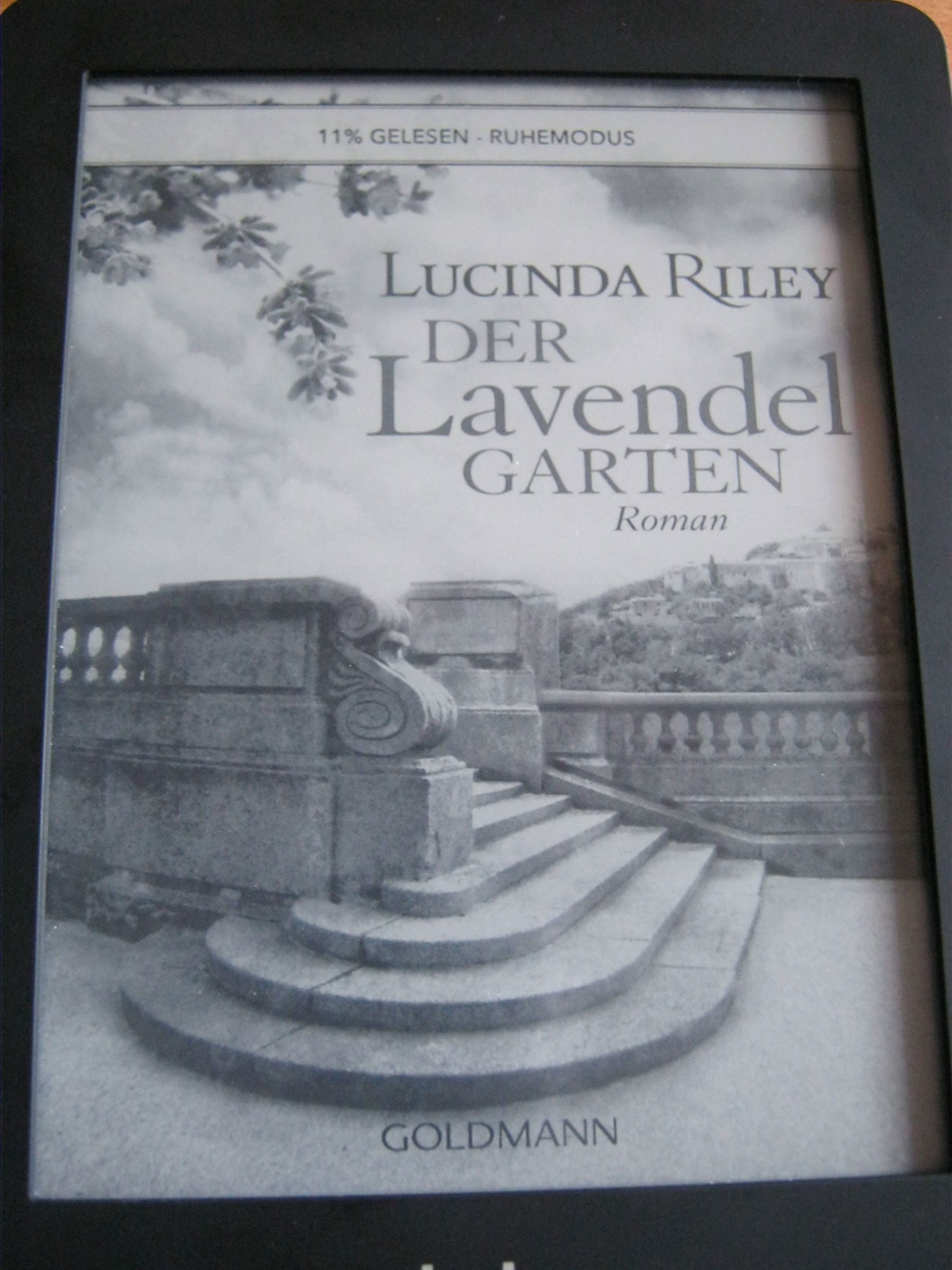

Are you sure that the device is booting correct, if only a blue light is shining? My working Glo shows a blinking LED in green after the blue LED when it is starting.
The background light can't be turned on. The computer can't detect the device. I left it plugged to the wall charger for the whole night. I removed the battery and tried to start with only the wall charger plugged in. I left the device without energy (battery removed) for some hours. Nothing changes...
I attached a photo of the screen - for me it seems ok?
Greetings!

Old 12-18-2015, 08:27 AM   #164
davidfor
Posts: 24,905
Karma: 47303826
Location: Sydney, Australia
Originally Posted by xter View Post
thanks for your support.
Just restarted my Glo, and you are right about the LED. The LED going off after a few seconds can be sign of a flat battery, but, if you have charged it, or started it while plugged in, this won't be the case.
I can't see anything on the screen that suggests it is broken.
It's beginning to sound like a problem elsewhere. The only things I can think of to try are:
- Reseat the SD card
- Replace the card and restore an image to it
- Check the cables for the screen
- Buy a Glo HD
davidfor is offline
