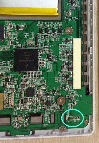

-charge the Battery for 4 hours, try to turn it on.
-check the volt of the battery with Multimeter if you have.
-connected + and - to the board see pic.

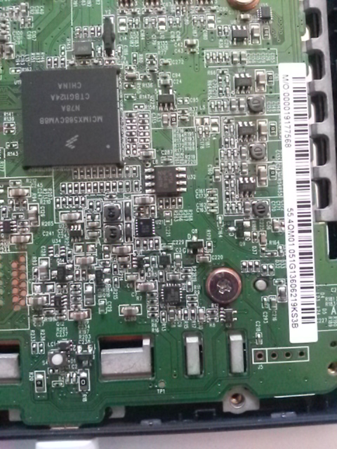

Thanks for your reply.
I've had it connected it to my USB wall charger for a couple of hours now. Will leave it and try again as suggested.
About your 3rd point:
On the motherboard of this KT, I don't have those signs that are pronounced on yours and it's not clearly visible in the picture attached.
Can you explain a bit more about this? what is it supposed to do?
Thanks
Thanks
I don't have a Touch.
you connect wall charger 5v, the red(+) to V, and the black(-) to grounding(three line).
in your touch the marking missing, see if you have another spot with marking.
I almost positive that the left pin is V(+).
in your touch the marking missing, see if you have another spot whit marking.
I connect red to left-most and black to right-most and nothing. So if doesn't work, I assume motherboard is bad, right?
thatworkshop is offline   Reply With Quote
