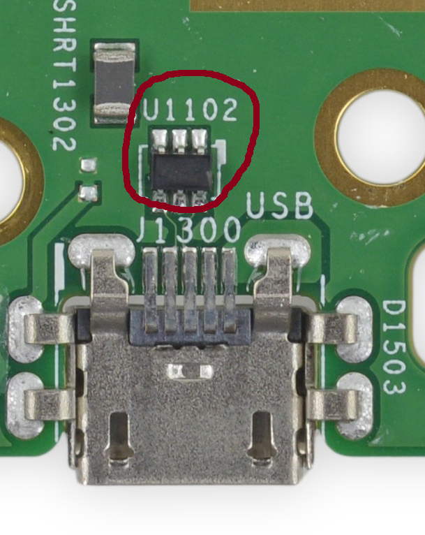

Looking for sign on a chip
Hi guys!
I have kindle 7th and when i tried to fix problem with usb connector suddenly i destroyed chip under U1102 sign (please see attached image).
Can someone help me with name of that chip
Thank you in advance

Old 10-18-2015, 05:10 AM   #69
knc1
Going Viral
knc1's Avatar
Posts: 17,212
Karma: 18210809
Location: Central Texas
Device: No K1, PW2, KV, KOA
What do you mean by Kindle 7th generation?
Amazon has at least 3 devices they attach that phrase to.
Use the first few characters of your device's serial number and this chart:
https://wiki.mobileread.com/wiki/Kindle_Serial_Numbers
to find the model distinctive nickname used at this forum.
What do you mean 'destroyed'?
It looks fine in that picture you attached.
Since it is directly connected to D-, D+ (pins 2 and 3) it must be some sort of USB, PHY chip.
Plus, keep in mind that is (well, is supposed to be) an OTG port connector.
(The connector pins, left to right, are: 5V, D-, D+, ID, Gnd in addition to the standard's interface signals, the Kindle's have a "charger source" detection on D- and D+)
Sometimes intense, transverse, lighting will pick up the identification markings.
Old 10-18-2015, 08:18 AM   #70
c00ler
c00ler began at the beginning.
Posts: 6
Join Date: Oct 2015
Device: kindle 7th
Dear knc1, thank you for your reply!
Attached picture to my previous message is a part of the picture that i found in this thread. My kindle pcb looks completely the same. To this message i've attached photo of my PCB - you can see tracks of my activities there.
Few weeks ago my PC stopped to recognize my kindle, meanwhile it charging w/o any problems. After short investigations i found that 2 middle pins (D- D+) of usb jack lost connection with pcb. So i decided to soldering them back. Suddenly there was an accident that destroyed part of the chip (body of that chip were badly damaged) under U1102 sign. Now i'm looking for that chip to replace.
Tomorrow i will check serial number of the kindle to find out model name.
c00ler is offline   Reply With Quote
Old 10-18-2015, 08:36 AM   #71
knc1
Going Viral
knc1's Avatar
Posts: 17,212
Karma: 18210809
Did you try a different USB cable?
What you describe is a "power only" USB cable.
That model is too new for you to have worn out the connector.
They are rated at over 50,000 insertions.
You haven't done that, even if you spent every minute connecting and dis-connecting the USB cable since you bought the Kindle.
You can find your device's serial number listed on your Amazon, Kindle Account page(s) - no need to put it back together.
What you have is not a KT2 -
The KT2 uses a surface mount USB connector, not that mid-line mount USB connector.
My bad, I was looking at the wrong picture in my picture gallery.
I understand you want the part number of the chip.
Let me re-word my earlier answer:
I do not know, you will have to look at yours using an intense, transversal, light.
Since you found the photo in this thread -
then you may have a PW-2, which I do not have.
(There are some PW-2 photos in this KT2 thread.)
OR
That is a different board revision than the one I have.
Destroying the plastic, molded, chip package does nothing to the chip -
Unless you mean you have exposed the actual silicon chip and its bonded wire connections.
Even then, you probably haven't done any damage to the chip unless you also destroyed the bonded wire connections.
But your attached picture, under magnification, does seem to show that you have lifted the traces between the connector and the chip.
I suggest that you find yourself access to a hot air, smd re-work station -
remove both the chip and the connector (using a quality solder removing paste) -
clean the board -
repair the pads and traces -
then replace the parts -
Note: both the connector and the chip look re-usable.
Old 10-18-2015, 09:03 AM   #72
c00ler
Posts: 6
Join Date: Oct 2015
Device: kindle 7th
yes, a lot of them. i saw under magnifier that D+ D- has no contact with pcb
surface of the chip is damaged with soldering Iron so sign is destroyed
On the first message of this thread there is an image attached with name "bottom-right.jpg". I see a chip there under sign U1102 - its exactly what i need.
That board is in storage along with the rest of the project thread materials.
It may be several days before I can get to it.
Why don't you just put the Kindle back together and return it to Amazon for exchange?
It is still under warrenty.
No problem, i will wait. I truly appreciate for your help.
I live in Russia and I bought Kindle in the end of 2014 when i was in USA.
Also not sure that this Kindle under warranty after my exercises with soldering-iron.
