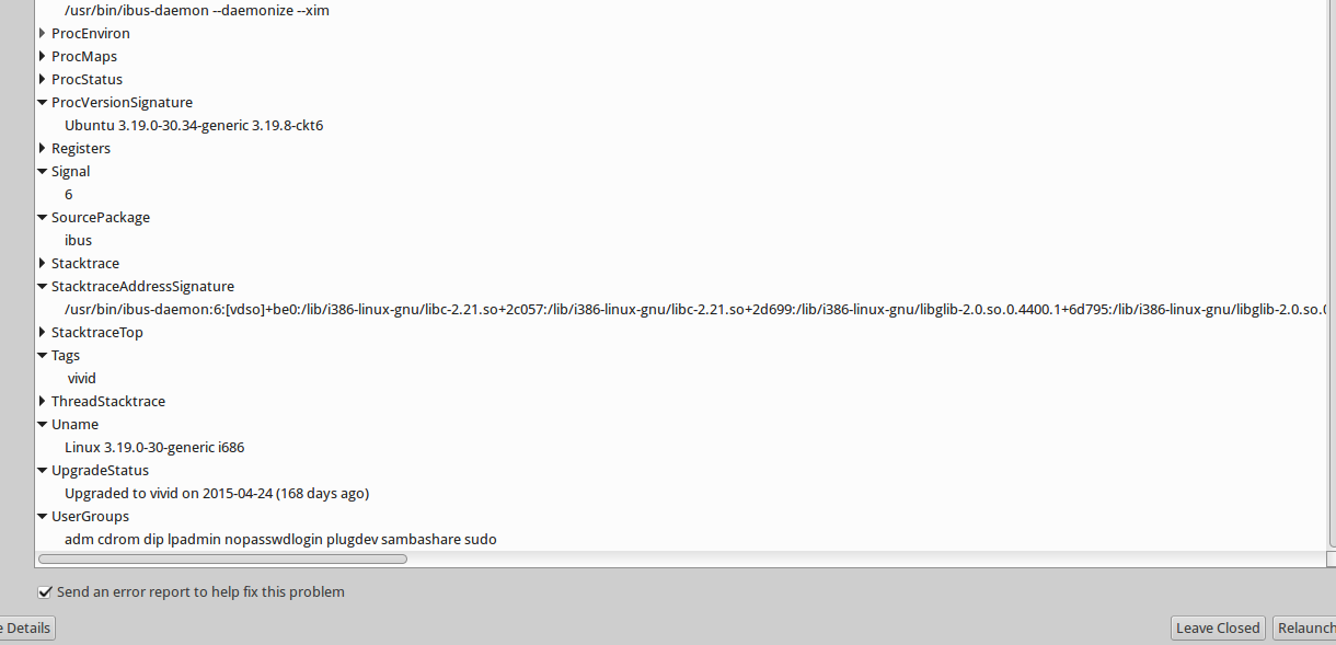

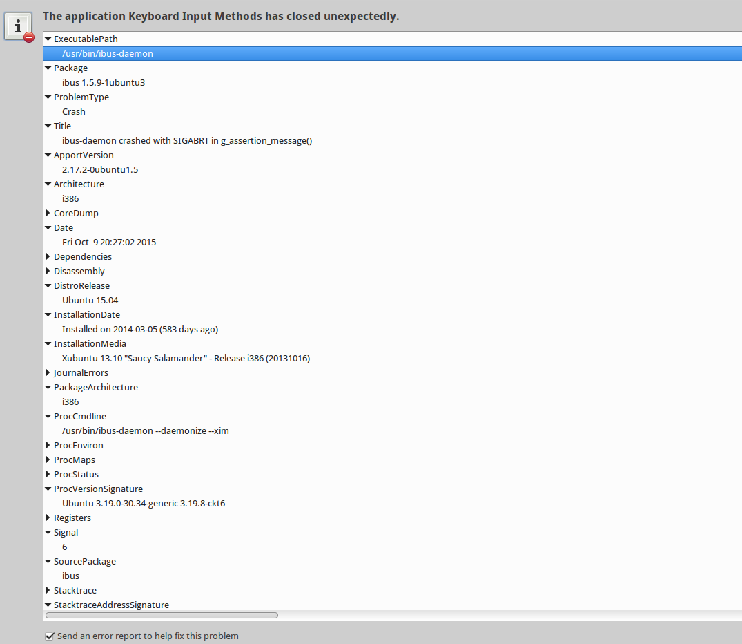

This window came up:
The application Keyboard Input Methods has closed unexpectedly.
I'm on Xubuntu 15.04 Vivid.
I copied the "details" and attached them.
I re-launched the Keyboard Input Methods. (I thought that might somehow be the problem because earlier I was using the F5 key for the 'next spelling error' check.)

The Keyboard Input Methods are system level not Sigil level. No where in your graphic was anything related to Sigil that I can see. It appears to be a linux system level failure.

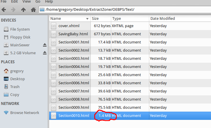

That said, try renaming the broken .epub file to a .zip file and then unzip it. Then open any of the .xhtml files in the OEBPS/Text folder with any other text editor and look to see what was written to your files.

Anyway, I did the renaming to a zip and opened it up and the last file I split got gigantic (see screenshot 73). I opened that gigantic section 10 html file in Kate and there were tons of non-breaking spaces. It started here (075) and ended here (076).

Every split worked properly until I got to xhtml10. Then it bogged.
Regarding your question in the other post about non-breaking spaces. The non-breaking spaces I added, those were all serving as scene breaks so "Chapter" would not be there at all. So it was impossible that a non-breaking space would get in the way.
What I thought was unusual was that on my home computer I could stay on Bookview while using the Find tool (in the process described above), whereas on my work computer (the one that I had the problem on) when I used the Find tool (in Bookview looking for "chapter") it kicked me into Codeview.
I need to work on this book, so what I was thinking was prudent was to do the splits in Codeview. (Although the User Manual suggests doing it in Bookview.)
Any suggestions for how to do the chapter splits without breaking another file? (I don't know if you saw theducks suggestion of doing shift-control-enter for the individual splits and then F6 to do the collectively.)
Thanks.
