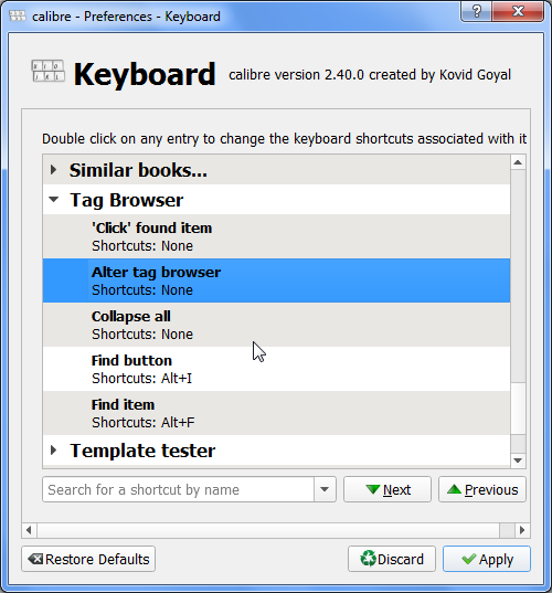

@BetterRed and @mariaclaudia: Kovid accepted my changes to add configurable keyboard shortcuts for some tag browser functions. The attachment shows what they are. Two of them have assigned shortcuts for compatibility.
The "Alter tag browser" opens the drop down menu and puts the focus on the first line.
The Click found item pretends that you clicked the mouse on the item found using the Find function, thereby changing the book list. It also "clicks" the last item clicked with the mouse, permitting rapid cycling through the searches.

@BetterRed: after some thought I decided to remove the two default shortcuts, so now none of the operations have defaults. Rationale: moving then to the general keyboard shortcut manager might create conflicts with user-defined shortcuts. Fixing this might not be obvious, leading to various confusing support questions. If someone uses the existing shortcuts then they will stop working, giving the person a good hint that something must be changed. Supporting the latter is easier, because the questions will be (or should be) more specific.
