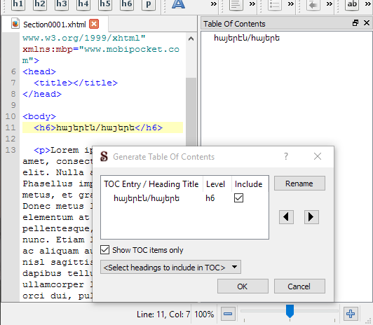

@DiapDealer: I was able to reproduce this bug with Sigil 0.8.9 on my Windows 10 machine. It appears to be caused by the span tags around the TOC entry. Without them, the Armenian text is displayed fine.
