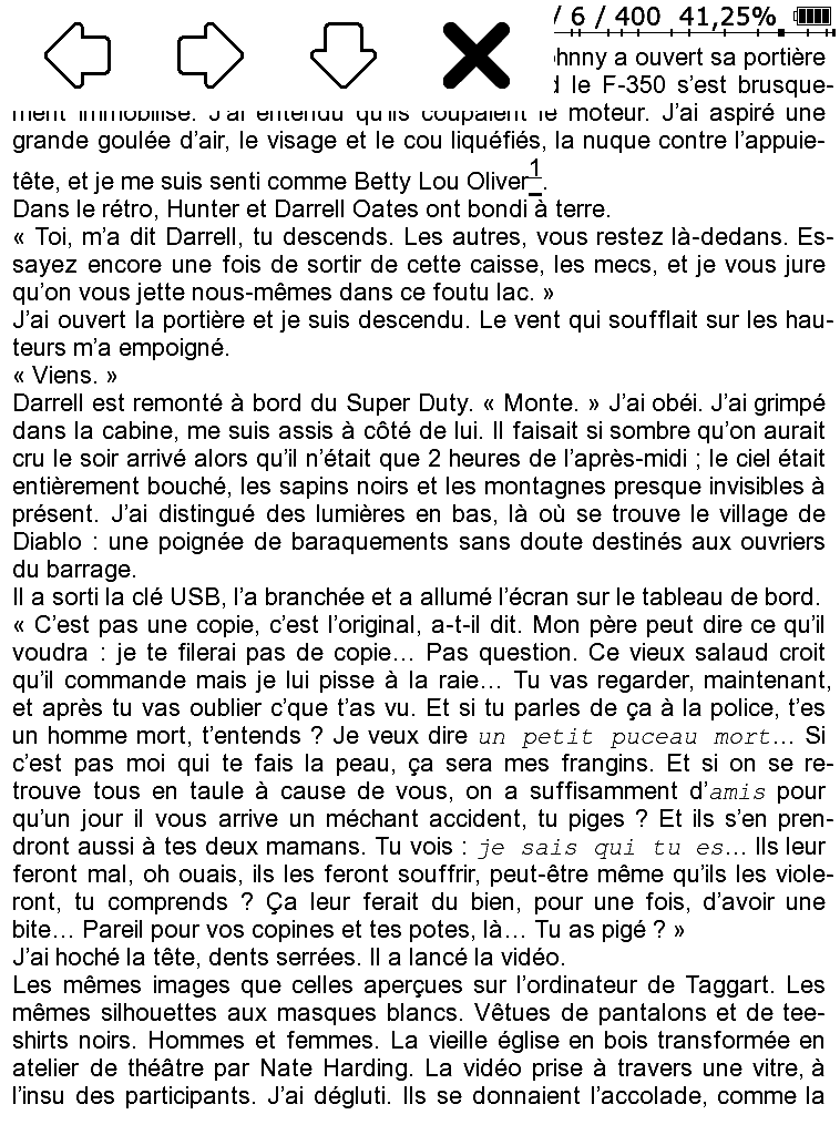

Hello,
the function "follow the link" in a book seems for me not working.
When I select this function, the link is underlined and a pop-up appears in the top of the screen.
The arrows are white and I can do nothing more, only close the pop-up with the cross.
I suppose the right arrow must be black, and permits to go to the link, no ?
Or perhaps I missed something...

Have you tried tapping the link after the arrows on top appear?

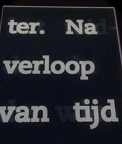

Tried the dev build, thanks for the effort!
Too bad the previous page text becomes apparent at the inverse stage (see attachment) of the full update and will leave traces after the final proces has finished.
When I tried to repeat the proces manually I didn't get the ghosting issue at first but when reducing the time - between a (fast update) page turn and a manual screen refresh - as short as possible resulted in identical ghosting effect.
It looks like the full update executes to soon and must be delayed for best display quality.
Somewhere between 100ms and a full second exist the holy grail
Brings a whole new meaning to the 'Don't use fast updates' phrase! LOL
