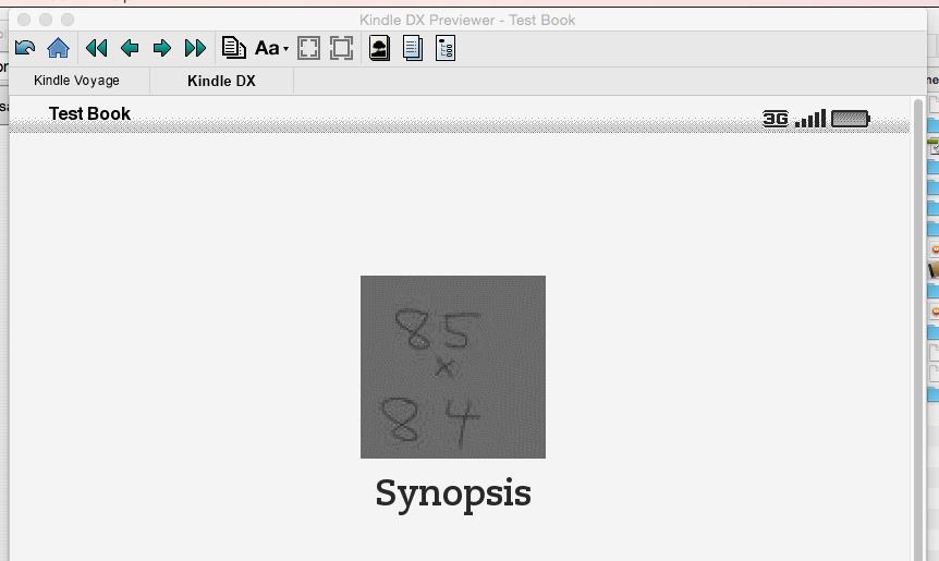

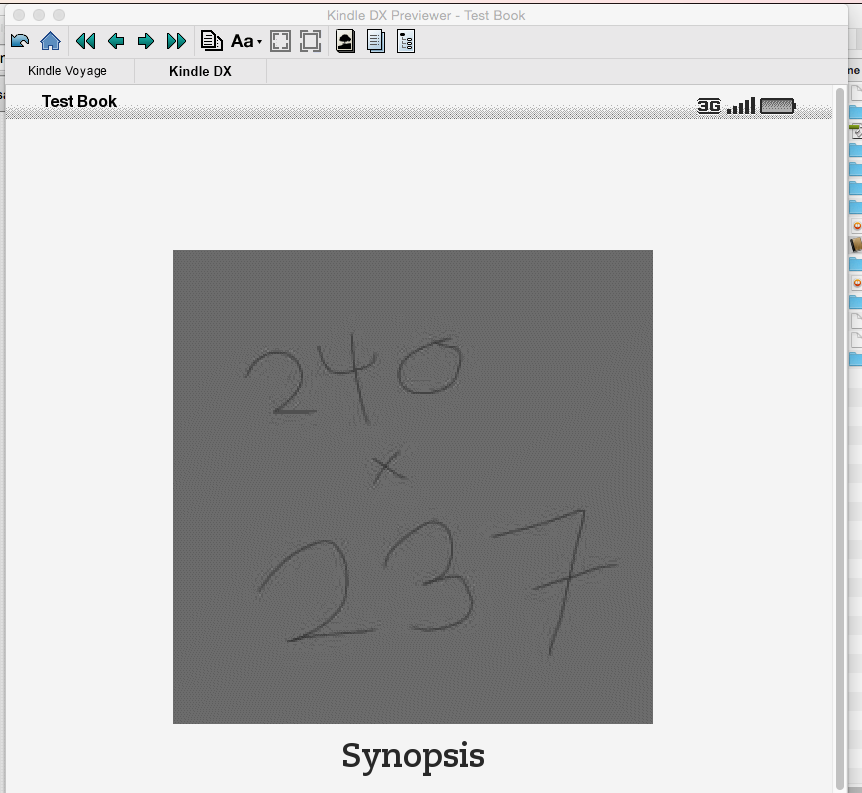

Old 08-30-2015, 01:14 AM   #12
mattmc
mattmc can program the VCR without an owner's manual.mattmc can program the VCR without an owner's manual.mattmc can program the VCR without an owner's manual.mattmc can program the VCR without an owner's manual.mattmc can program the VCR without an owner's manual.mattmc can program the VCR without an owner's manual.mattmc can program the VCR without an owner's manual.mattmc can program the VCR without an owner's manual.mattmc can program the VCR without an owner's manual.mattmc can program the VCR without an owner's manual.mattmc can program the VCR without an owner's manual.
Posts: 89
Karma: 185923
Join Date: May 2015
Device: iPad 1/2/Air, K3/PW2/Fire1, Kobo Touch, Samsung Tab, Nook Color/Touch
The K2-->DX family of KF7 devices won't obey the size of the image. I can tell you that without testing. The fact that the image will blow up to the full size of the screen, without any constraining code, is well-established.
The K1 is a very poor testing platform, I'm sorry to tell you. If you test on the DX emulation on the Previewer, you'll have a far more reliable indicator of the vast majority of the devices than using a K1. I can't even imagine where on earth you found one these days, but...{shrug}. The display capabilities/mechanisms of the K1 are not similar to those of the k2-->etc. Without trying to sound remotely snotty, seriously, you can have a K2 in days, if you look around, or a DX, in 1-2 days if you order it from Amazon, and you'll be a lot closer to what you need, than with a first-gen Kindle.
I can absolutely tell you that the only way to get decent image sizing on any image smaller than 100% of the width of the screen is to a) set it using % in KF8 and b) set it using pixels, inline, both height and width, in KF7. That's it. You can do it either with both inline (% and px), or with the % in CSS and the px inline; but it needs to be done.
Test it on the KP. You'll see what I mean.
Hitch
Found my K1 one on eBay, $50
Hm. Okay, so, I caved and ordered a used K2 on Amazon. What the hell, why not?
Next order of business, Kindle Previewer. I'm running the latest KP for OSX, version 2.941. I load in my book and switch to "Kindle DX" mode. Nice, big screen, no embedded fonts, seems like a legit KF7.
So, I made two test files, attached screenshots kf7-image-test-large and kf7-image-test-small.
Both files, when unpacked, have identical KF7 markup:
<h1 height="9%" width="0" align="center"><font size="+3" face="Adobe Garamond"><img src="Images/image00852.jpeg" alt=""/></font></h1>
(Interesting, in some earlier tests I had not seen any height or width inline attributes being created by my CSS, and I'm not adding them by hand...and I wonder at the percentage and the zero in there...)
The images in either version are different sizes, as I put into the actual image, and they're clearly displaying at different sizes. Neither are filling the screen.
(As I said earlier, if the image is bigger than the screen, it'll max out at 100%. But that's not quite what you've been saying.)
Thoughts?
ID:	141503   Click image for larger version
mattmc is offline   Reply With Quote
Yes. It is. I use it extensively for a quick check on books; I only slap the files on the "real thing" when I feel a qualm about something. Both the Voyage (KF8) and DX (KF7) are highly reliable previews.
I'm obviously missing something. I don't understand why you have two different files? And why wouldn't the files have identical KF7 markup? Can you please elaborate?
Thoughts?
Sorry; I made two different files with two different sizes of image. I was trying to see if the size of the image file would have any bearing on how big it was displayed on the screen. So I saw that the same markup was produced no matter the size of your image--a logical conclusion, but whatevs.
Yes, I have a bunch. I wonder if we are somehow miscommunicating, or if I'm misunderstanding your intent? I hope you don't mind my questions, to obtain some clarity:
  1. Why are the images inside a header? H1, to be precise? I noticed this, I think, earlier, but thought it was anomalous, but here I see it again? Why is this?
  2. You have a bunch of mixed instructions here. I see a height instruction of 9%--which is for what? Is that intended to be for the image, or for the heading, that's containing the image?
  3. Then there's a font size of "3," which is typical KF7 sizing.
  4. My inference is that the heading is being used to constrain the image size. That's what I see--just like using divs to constrain images for iBooks, essentially.
  5. The % shouldn't work at all, for this. That should affect the view on a KF8 device, not a KF7, assuming that it's interpreted to be for the heading.
Questions are good; clarity is good
  1. The images are inside a header because that's the markup that InDesign generated. No more, no less.
  2. Sorry, I was confused earlier and thought that the 9% was on the image, but you're right, it's on the header tag. That was what InDesign generated; I don't know what purpose there is for putting a % height setting on a header.
  3. Font size 3, sure. Again, ID-generated.
  4. Mayhaps. Again, not intended that way, but maybe that's what's happening. (I am familiar with the iBooks image problem and the workaround.)
  5. Interesting, okay. So basically the sizing settings on the header, a % and a zero, aren't doing anything, based on what we know of KF7.

The datum you've given me is that, unless you specify a width and height on the img tag itself, it will blow up to 100% of the screen size.
What I'm seeing is that the image is simply being displayed on the screen in the size of the file, regardless of any width or height attributes on the img tag. As you can see from my screenshots, I made 2 files with different sizes of image, with the image sizes painted in the image itself for clarity. And you can see from the screenshots that they're displaying at two different sizes in the DX Previewer.
(It's just different behavior from what you were saying, hence all this. )
So then, you're theorizing that this behavior is because the img tag is within an h1 tag. As we've gone over, the h1 tag isn't even really constrained to any particular size, since the size attributes on it aren't supposed to be applicable to KF7. So the idea is that by simply putting an img tag inside another tag, you can prevent it from expanding to 100% of the screen size...right? (Similar to the ibooks bug, except you don't have to do the 100% width/height on the img, and the explicit size settings on the constraining div/span.)
If that's true, then there's two ways to constrain image sizes on KF7. Remove the img tag from everything and put sizes on it, or stick it in another tag. That would be the conclusion, just two ways to go about it. Next time I'm at my desk I'll pull the sucker out of the h1 tags and see how it looks. Based on what you're saying, it'll explode up to 100% screen size.
Anyway, I hope that I've clarifies? In the end, it just may be that we accidentally found another way to counter a sizing bug on KF7.
