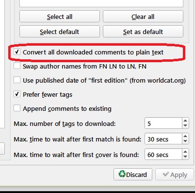

You might avoid this in the future by making a metadat download setting change
Name:	Save as Text.jpg
Yes, I have indeed made that change to prevent this in the future. I may end up re-downloading the comments as needed to fix this issue. Thanks.
