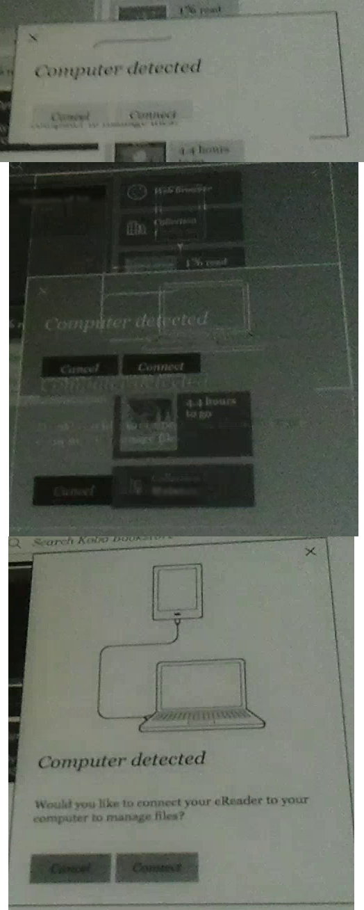

A minor glitch, not sure if new in 3.17.3, but I did not notice before.
The "Computer connected" popup is drawn twice, first time a small window with incomplete image, then another time large complete image. Hard to make a photo of as it's only there for a fraction of a second... ended up using my stone age smart phone video camera
Noticed it also in 3.17.0.
throsu is offline   Reply With Quote
Wow, u are fast I didn't managed to make one..

@frostschutz: Yup, noticed that on 3.17.0, too.
