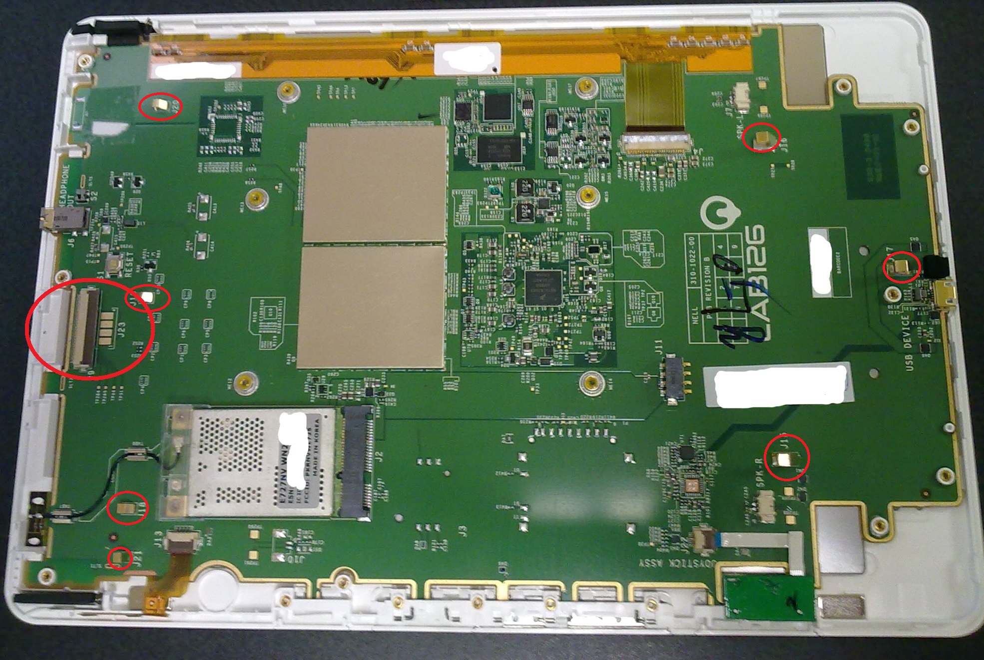

- There is an unused port (circled in red, middle left of the image attached), I'm wondering what is that?
- There are seven prongs (labeled as J15 - J21) on the motherboard, what are they?!!!

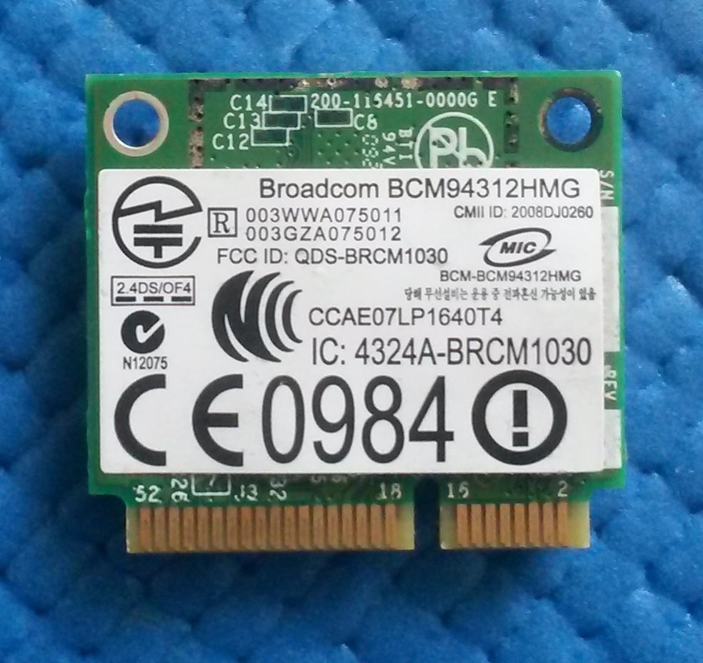

I also bought a Broadcom BCM94312HMG WiFi module. I'd like to have WiFi on this thing.
On the small screen model (K2) that is suspected to be a factory test connection.
The serial port connections are those four pads next to it.
See the DXG prefix, wiki index (under "serial port").
Click saver: https://www.mobileread.com/forums/sho...55&postcount=1
Not exactly well documented, but that is what we have on-hand here.
Ground connections to whatever was on top of this motherboard.
Meaning your going to replace your 3G modem with the Wifi module?
What part of the connector does that Broadcom module use?
Only the USB leads?
(Because those are the only ones wired to anything on the motherboard - I.E: the other PCIe pins are not used.)
Q: Does that Broadcom module have a built-in Wifi antenna?
(You can't just re-use the 3G antenna.)

N̶o̶,̶ ̶t̶h̶e̶r̶e̶ ̶i̶s̶ ̶n̶o̶ ̶b̶u̶i̶l̶t̶-̶i̶n̶ ̶a̶n̶t̶e̶n̶n̶a̶ ̶i̶n̶ ̶t̶h̶i̶s̶ ̶m̶o̶d̶u̶l̶e̶.̶
Edit: Well, there are 2 female plugs for antennas, and luckily I do have the proper antennas. Look at picture in next post.
Well, I don't have a solid idea how I'm going to do it, but I'd like to. As I have mentioned somewhere earlier, there is a guy who did for Bluetooth here.
So those 7 prongs are for grounding connected to the backplate? Oh, I put a piece of paper behind the backplate, as a precautionary measure not to touch the internals and motherboard's juicy electronic stuff (including those J15-J21 )

Sometimes Broadcom literature is hard to find, but start by web-searching the full part number.
You may be able to find the data sheet (including connector pin out used) for that module.
Same with the 3G modem/radio.
If they are both USB, then cobble in a usb hub chip in the existing lines to the 3G module.
That will give you another USB (host) port or two inside the case.
