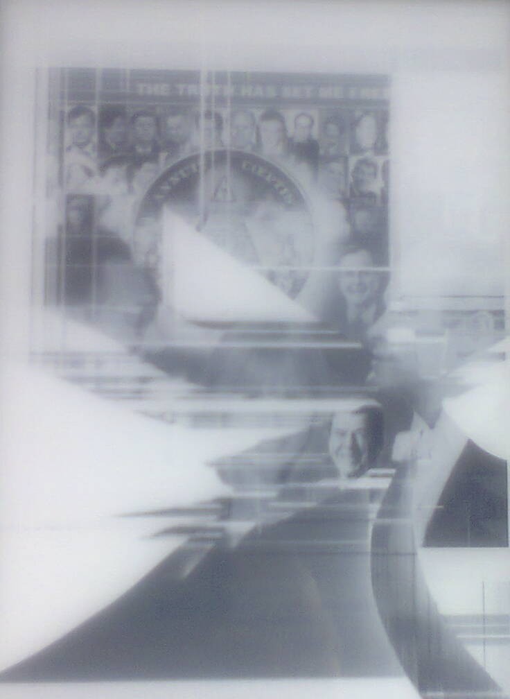

here is the screen..

The issue with temperature differences and actually opening the case, is the possibility of condensation forming on the electronics. If you could put it in a moisture absorbing environment, you might be able to dry it out. If you are very lucky it might not already be damaged beyond recovery.

The screen of the Aura HD is broken. The glass substrate has broken. It's due to the extreme temperature in the car or going from the car to the house.

Drying out the HD won't matter since the screen is broken.
Or it was twisted or bent or dropped or impacted, who knows. It's well and truly smashed either way.

wasnt smashed at all... screen is intact.. its just the ink or the circuit underneath...

The heat in the car most likely caused the problem.
