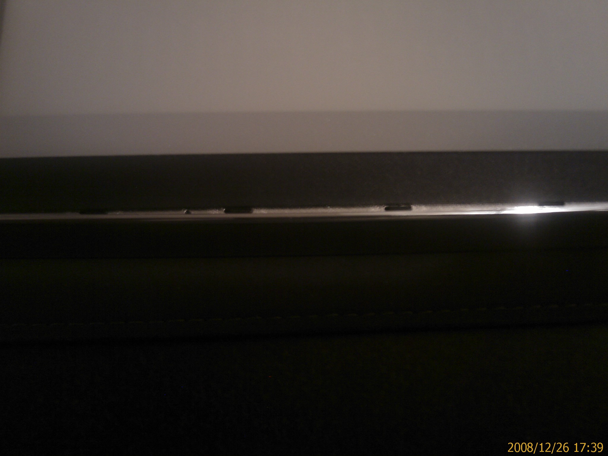

Hi all.
I have had the 700 for 45 days, no single scratch on it but since yesterday have a problem on the case. Right side of it has been moved away from the main body, leaving a gap. I cannot describe it well, attached are 2 pictures. I have had 500 and 505 before this one for almost 2 years and know how to take care of my devices. Reader hasn't been dropped, there has been no pressure applied to it at all.
I today contacted Sony today, got an email to send the reader to them and wait for repair. I'll call them tomorrow and ask them to send a new unit first, if possible.
Has anybody else seen this problem?
Thanks, David

I had the same problem. I took my device back in to the Sony store and they replaced it. I'll bet it is a device design weakness...
I hope my new one doesn't do that too...

Originally Posted by ddavtian View Post
Hi all.
Thanks, David
Let me Know if they do cross ship you a unit. i plan on calling and seeing if i can go to a sony style store and replace it. cause i dotn want to be weeks without my reader..
I just broke mine like it cause i didnt think it would be too hard to fix. here is how i fixed it.
its the stylus. if you put the stylus into the the carrier halfway then Pull or push it enough it will pop out. its a simple fix.
I decided to break mine like it, had the same thing.
first Remove the 4 screws on the back, then the two screws on the bottom then 1 scrow on top. remove the bottom plate, remove the volume button and the magent, under this is the final screw, remove it, then remove the top/side plastic plate.
you probably bent a few of hte plastic pins trying to wedge the sidin back in. straiten them to about 30 degrees and replace, and put back all the screws and plates.
go to the disassebly thread here for pictures https://www.mobileread.com/forums/showthread.php?t=34401
here is the flicker with instructions http://www.flickr.com/photos/2172951...7611324679087/
just follow the first 3 steps.
i hope i helped.

Thanks Andybaby. Sony tech support said they couldn't ship a new unit, had to see my reader and repair it. I did not speak to customer relationship, they were closed on Saturday.
Then I took the reader to Sony Style (Stanford Shopping Center in Palo Alto, California), manager was very nice and exchanged the reader for a new one.
I hope this one behaves better.

Yup, I have the same problem. However, there are a couple of nicks in my case right where the clip would be, so it can appear to be due to my dropping the unit (which I didn't) so the guy at the sony store is giving me a hard time... I'll try and call tech support to see if they can do any better. Failing that I'll give fixing it myself a shot - i would like a replacement instead, however

I recently got the same issue after I dropped my Reader. The solution turned out to be pretty simple:
1. Remove the stylus.
2. Turn the Reader over and remove the top left screw from the back (the one that's holding the popped out side plate)
3. Slightly shift the side plate up until its drops into place. Then shift it down until it's firmly fixed.
4. Put the screw back.

Igor spasibo!
Thank you, it was easy fix
Now, if you can find an easy way to clean dust
ddavtian is offline   Reply With Quote
