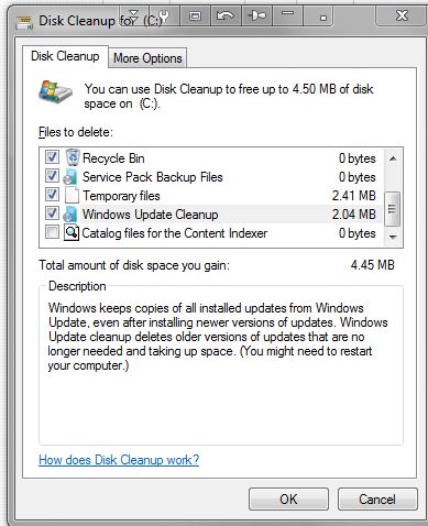

Chaney, also I can at anytime manually start a windows system file check.doing so does not freeze my controls.
So it is being raised again because the root cause of only calibre doing this is still not found or fixed I don't accept that nothing can be done about it, if we collectively pool findings
I think chaley is referring to the 'Windows Update Cleanup' in the 'Disk Cleanup Utility' which is different from the 'System File Check' utility
I run Disk Clean Up weekly
Attachment 140478
ok yes, but I can , and do ,run that manually and it does not freeze my PC.
i think the links to windows update processes account for some delays to calibre launch but do not explain away the freeze, which , as Harry also points out. is calibre-specific

1. yes I have the font vulnerability update.
2. after re reading Chaley's advice I decided to go one more time around the disk cleanup merry go round.
Previously, disk cleanup it had stubbornly said "nothing to see here, move along now," but after this weeks windows updates it decided there was stuff worthy of deletion... and after a reboot at which it went into cleaning up... mode I seem to have eliminated my freeze. I used to have in immovable 100+MB in winsxs\temp\pending_renames but that has all gone now
so I quickly made a fresh system image and am off to practice " if it's no longer broke, stop fixing it.. "
cybmole is offline   Reply With Quote
@cyb - if you ran with UAC on, I think you had to run the disk cleanup as admin to get the extra options, like clean up WU and scrap service packs etc. I run with UAC off.

I also run as admin and with uac off. So it is a mystery as to why clean up worked today. Except that there have been several fresh updates this week
