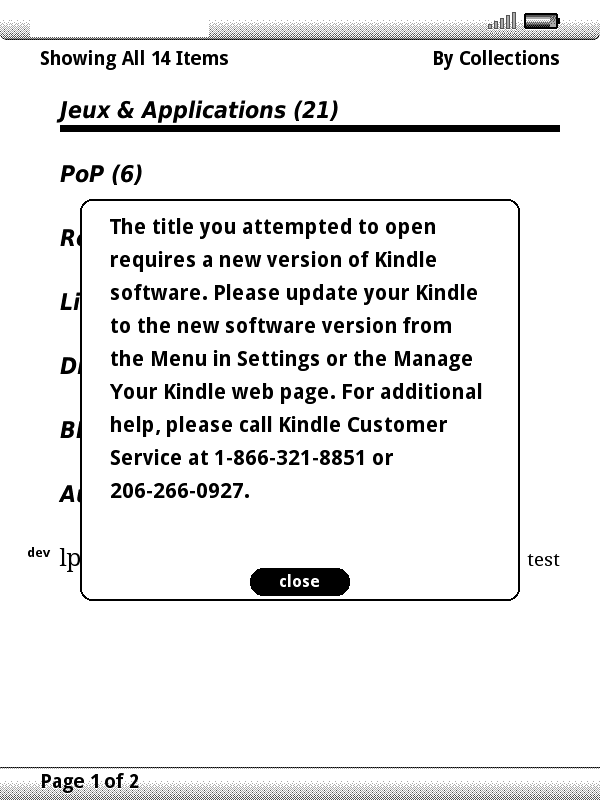

Sometimes an idea « let's make the Kindle a printer » seemingly pointless, can deceptively be used in a new, simple and surprising way. I call these gems.
Respect @DarkTrick
Too bad my K3 v3.4 software is too old to try further :
Name:	screen_shot-19024 on a K3.4.png
... Nah no point to call Cutomer Service.

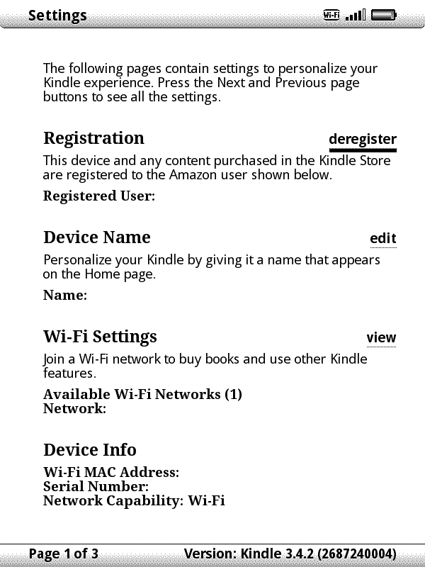

Ah really! I am on just on v3.4.1. I'll check for a 3.4.2 upgrade and update my post.
EDIT: 22h
I just manually upgraded (interesting that I never received an OTA update) to 3.4.2
Alas same message : it is too old.
Last edited by PoP; 07-21-2015 at 10:02 PM. Reason: updated firmware and rechecked
