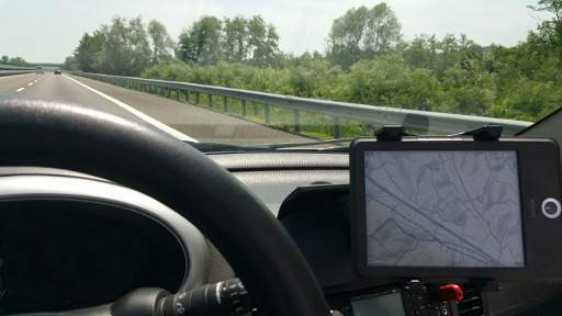

Proof of concept

I met this thread a few weeks ago, and I loved the idea.
I made it work this evening.
I am using OruxMaps on a T68 (*) connected through BlueTooth to the GPS of a telephone, through com.jillybunch.shareGPS and com.Saenko.GpsOverBt.
Now it is a matter of checking whether the system is battery efficient for normal use on a car.
* BTW the T68 flashed with the 1.8.2 found at Booxtor's is amazing.
Old 06-16-2017, 04:44 PM   #9
mdp
Posts: 1,481
Karma: 9010563
Join Date: Jul 2013
Today I tried it in a "real world scenario".
Apparently, to send the GPS signal via BlueTooth com.jillybunch.shareGPS is sufficient (the other software earlier mentioned does not seem to communicate to OruxMaps).
The "telephone" (GPS+BT) seems to consume a meager or acceptable 120mAh. It would be nice - simpler and more efficient - to have a GPS radio on the tablet, but on the other hand most people will carry a telephone anyway, and the communication does not consume that much.
The T68 seemed to consume between 5% to 10% of battery per hour, but the measures did not look well calibrated.
I could not find an option to update the GPS data less frequently than every two seconds - again for battery efficiency -, but it must be possible.

The project seems to show capable of a pretty stable implementation

I now used (and on a different telephone, although this should be irrelevant) a setting of 8 seconds as "GPS timer" option in com.jillybunch.shareGPS : this actually was reflected in the screen update, slower as I intended.
Nonetheless, the T68 seems to work as a map/geo-positioner device, OruxMaps based, for about 6 hours. Which, then again, is not really a problem, having the ability to keep it charged through the car battery.
