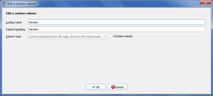

These is my version of the columns you're looking for.
I don't have a screenshot for my warnings column at the moment.
For the Ratings and Fandom-columns you should be able to select the right info in the custom columns tab in FFF.
For the AO3 categories you need to have the following in your personal.ini
custom_columns_settings:
 ao3categories=>#categories
provided that you name your column the same way I did.
ID:	139960   Click image for larger version
ID:	139961   Click image for larger version
Thank you, that's extremely helpful for a start! Is there a place any of these instructions as pertaining to fanfic can be found so I don't spam this forum? I found FAQ for composite columns but I don't know if those will apply to me.
