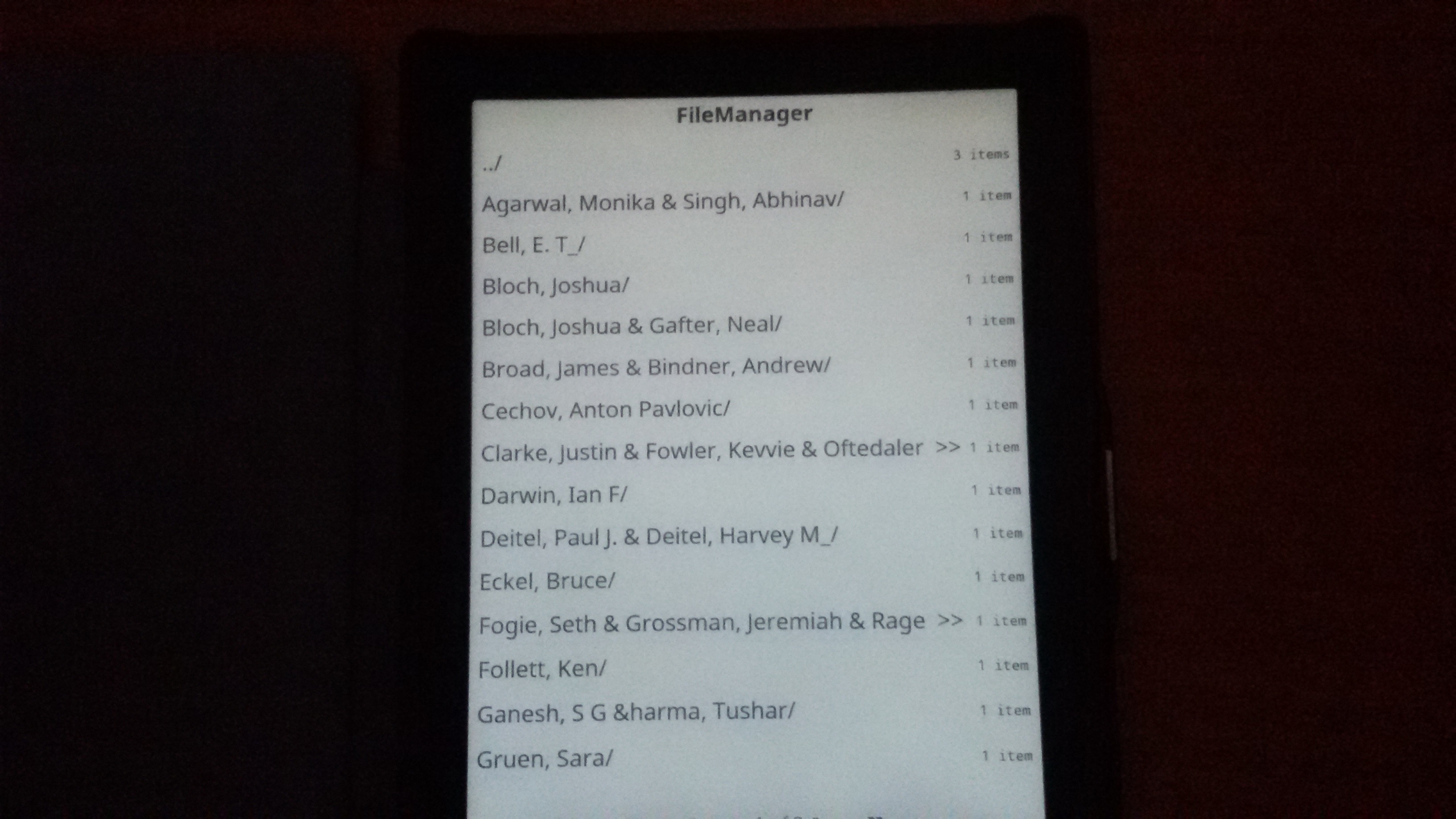

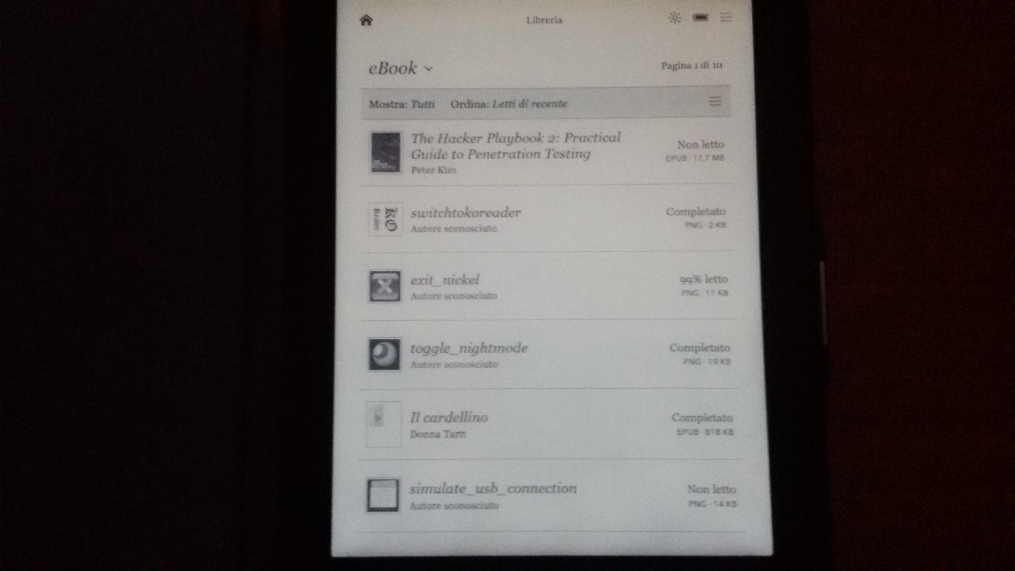

Hi,first of all thank you very much for all your effort in making such interesting options available to end users.Really appreciated.
Just installed latest nightly build on my Kobo Aura HD with latest fw.So far everything seems to work fine.
Just an annoying thing: how could I set Koreader FileManager to show bokks titles before authors?I manage my library with Calibre and I have not modified any option.
Here there are a couple of screenshots:
Koreader File Manager
Attachment 139814
Nickel library
Attachment 139815
Thanks a lot.
Marco
The file structure that calibre creates on your device has Author Folders with the book files, for that author. So, if using the caliber generated file structure, when you browse you have to start by picking an author. Calibre is very adaptable and you may be able to change how it builds the file structure on your device. You might want to take that up in the calibre forums.
There are some advantages to using the calibre generated, for Koreader in that Koreader has a function to search the metadata file that caliber maintains with the file structure it creates. I prefer my own file structure, but I still use calibre on my PC. I even often use calibre's content server to add new books to folders on my device.
You can make your own file structure, of course, mine has category folders like: Action, Mystery, SciFi, Fantasy, History, PolyTicks, Humor, ect...; inside those are the book files. The files are naturally in alphanumeric order with the files named by Author, series, title.
You can make any file structure that the FAT32 file system will accept.
