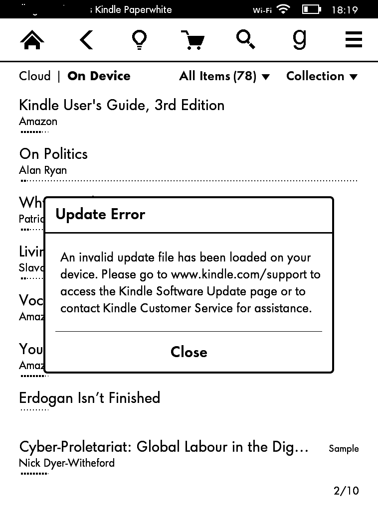

Reported by: oumlaut Who also reported that the 'bridge' did not appear to have worked.
5.6.1.1 silently ignores kindle-jailbreak-1.14 and kindle-usbnet-0.18. I also gave the hotfix a try. Kindle issues an "Update Error".
