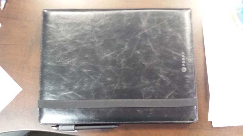

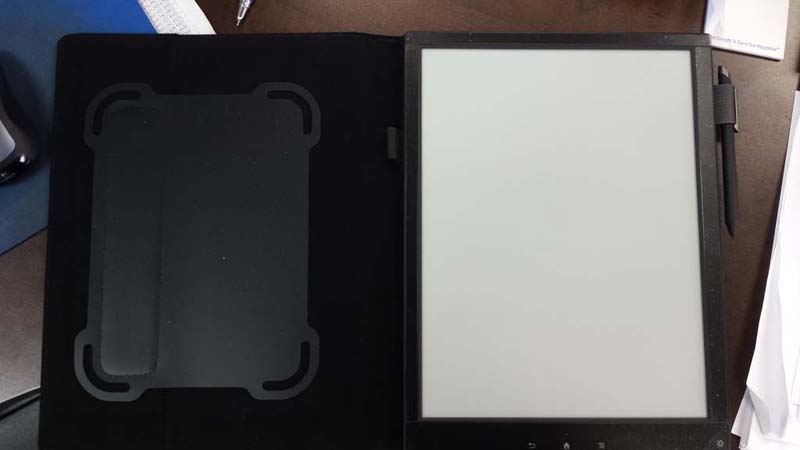

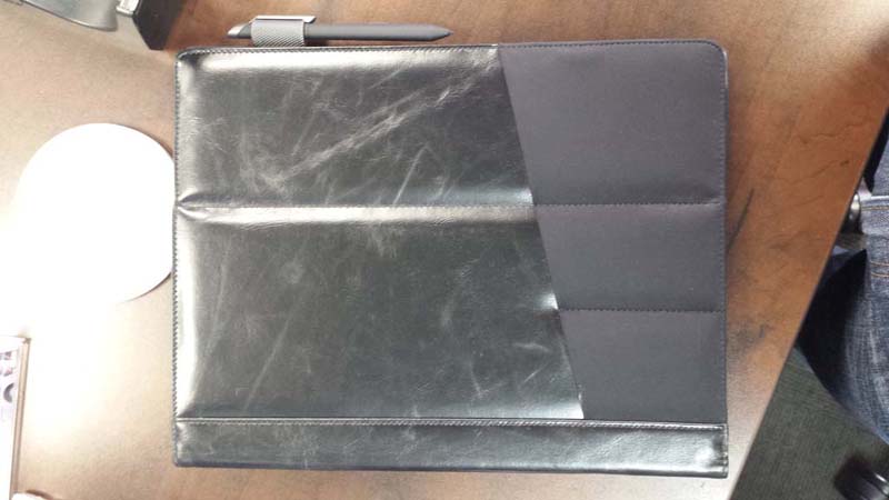

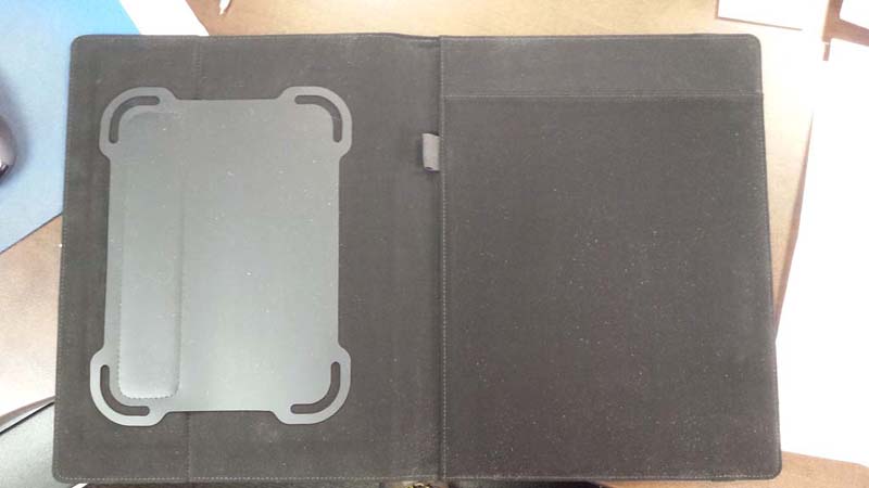

@gbgbgb, @rem736: could you make a photo of the DPT-S1 in the Padfolio?
Thanks

FORAY Pad & Tablet Folio, 9 1/2" x 12 1/4", Black (# 844148)
@md02439, here you go. this folio has an elastic strap that wraps around to keep the folio closed. it is sized too perfectly for the DPT-S1, leaving the pen sticking out of the cover, which is a negative. it does have a pen holster on the inside spine. however, using it will cause the reader to stick out. so i decided not to use that holster. besides, removing the holster from the DPT-S1 leaves a hole, which could lead to dust entering the unit.
