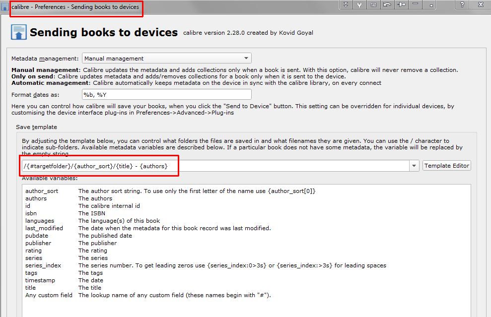

@korben - perhaps you need to adjust the template in

Whatever template the OP had, it should have been consistently (right or wrong )
I can't think of a Calibre setting that would randomize the results
@theducks - if the template was changed, then books sent after that would get file names as per the new template, whilst books sent before the change would remain as is - wouldn't they?

BR : the template is set correctly and I haven't made any change in it since a long, long time (I checked before answering, we never know ) so I do not think that's the problem.
